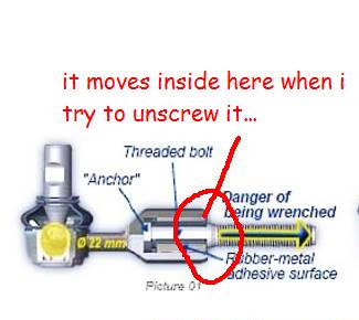

i tried removing the driver side tie rod end, but i couldn't get it to unscrew. everytime i tried forcing it to unscrew, it seemed as though the bolt was moving inside the connection point to the wheel, if that makes any sense. is the long inner bolt supposed to move inside the housing? i was going to try to keep twisting, but i didn't know if i would just break.

when i secure the steering rack with a wrench, and try to unscrew the tie rod end, it moves inside because i guess its rubber inside. how do i go about unscrewing it? it feels like its just going to keep moving inside the harder i pull on it.

ok, nevermind, i just kept twisting it unscrewed.... problem is, assembling back together, broke the top bolt, how dangerous is this? i figure the side bolt that clamps it through the groove should be enough for now, right? if not... yeah, fun times are ahead lol
