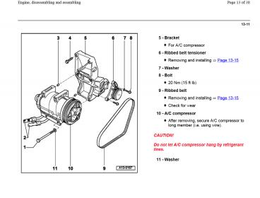

Mine wasn't the AC Pulley...if you can get to the HOLE where the bolt is without removing it all, you can get a re-threading tool in there...I take NO responsibility for suggesting this...re-threading is a little tricky sometimes....and takes patience and some skill....is this the pulley you're talking bout? #6 in the attached Pic? This is the compressor and pulley diagram for the ATW engine code of yours...looks like the tensioner has 2 bolts, right?
You won't know if it's the bolt or the block until you remove it...most times though....it is the block that's stripped.....but then again, I usually have bad luck....

hey thanks man, so ya it's the #6 bolt... i cant get it tight to hold tension on the belt so it's on there a little loose and squeals when i turn it on at low speed or idle. it looks like it doesnt actually go into the block though, does it tighten down into the ac bracket?
Old May 28, 2014 | 03:06 PM
markymarc's Avatar
Joined: Apr 2009
Posts: 675
From: Des Moines, IA
Yes, the tensioner is bolted to the A/C compressor bracket.....
