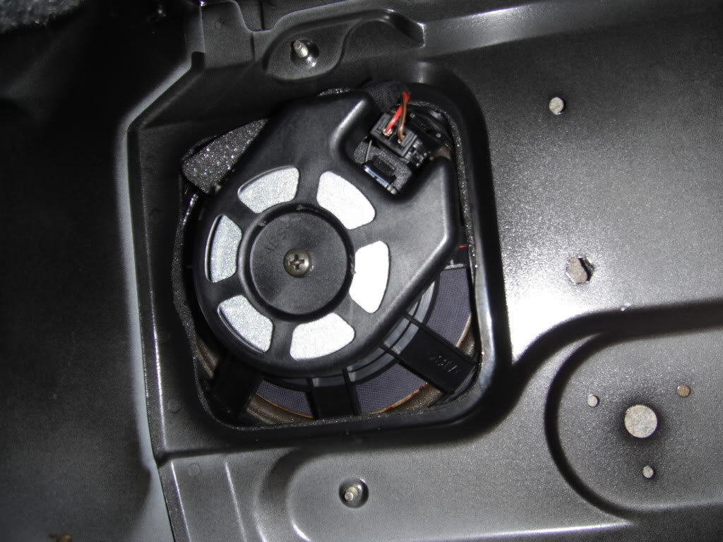

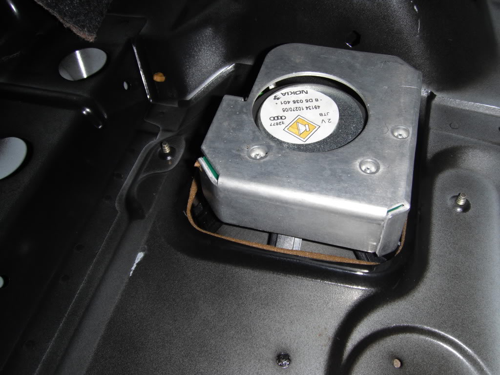

Here are some photos of my rear speakers...
Can somebody point out where the amp is then?

The aluminum casing around the magnet of the driver side speaker, that's the amp.

So where would the RCA ports be? I have just had a feel about and can't feel anything.
I will unscrew it later when I get hold of my tools, but I can't see a way that it can attach by RCA cables, it seems far too small.

There are no rca's; the signal and power lines are hardwired in.

They were right. You have to manually connect it at the headunit. I don't know if Audi used shielded wire or not but you'll need to find a wiring diagram, and install rca connectors on the low level signal lines headed to the rear amp. That way you can connect it to your standard headunit preouts. I'm sure this has been done before on these cars. I would do some more research.
The other option is run speaker wire from your new headunit to the rear speakers, or install a small amp.
