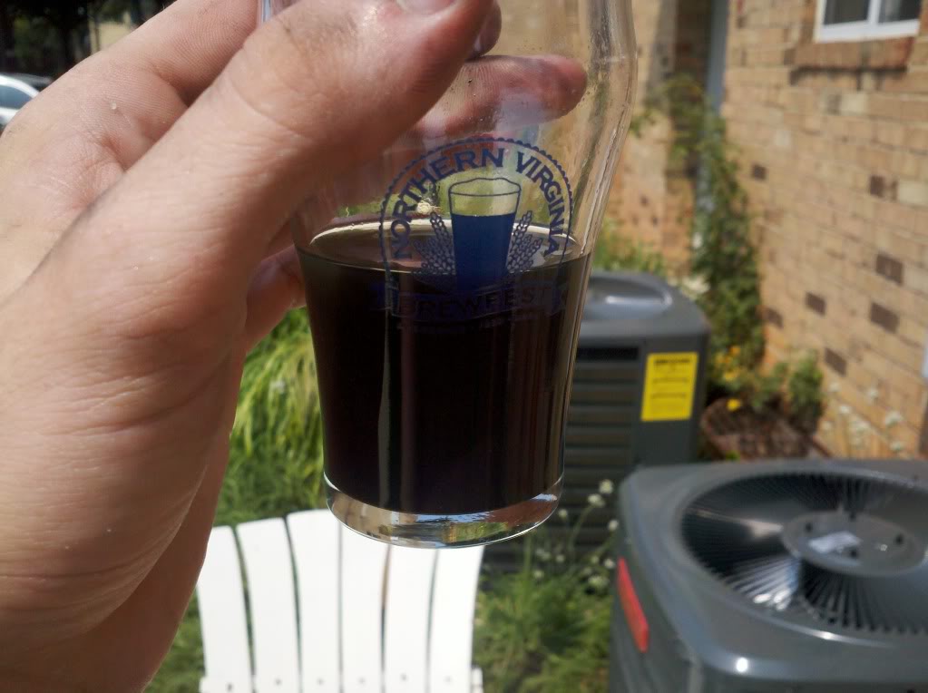

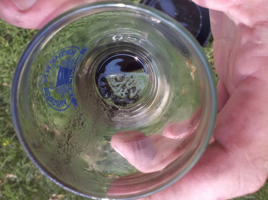

2 Attachment(s)
This is the stuff that came out of the inlet side of my filter when I disconnected it:
Attachment 28722
Attachment 28723
Just sayin...
Sheasta Jul 24, 2012 04:59 PM
Chocolate syrup, yum.
CCA4 Jul 24, 2012 06:08 PM
It was more the consistency of coffee if you made it with no filter. Super gross lookin and smelled terrible
