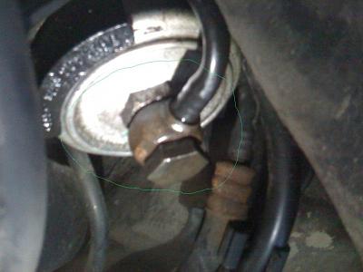

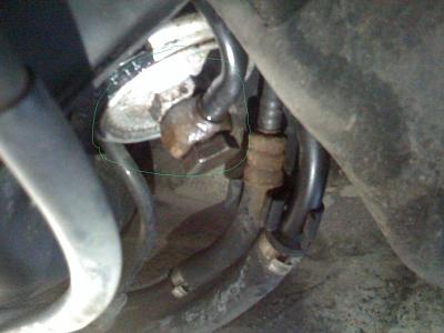

hello everyone, i have a bad fuel leak under the back side of my 97 audi a4 1.8 turbo quattro. it only leaks out when the car is running. i know where it's leaking from, but i don't know what the part is called. i placed a couple pics up here to see if anyone on here knows what it is. i appreciate the help.

fuel filter/ pump probably if its near the tank in the rear of the car...just replaced mine took about an hour an 10 min

well its a good time to change your fuel filter anyway. just make sure you pick up 4 new cruch washers (2 for each side) with the filter and it wont leak.

i just had the same problem and replaced the filter and washers. here is the diy:
http://www.audiworld.com/tech/eng49.shtml
