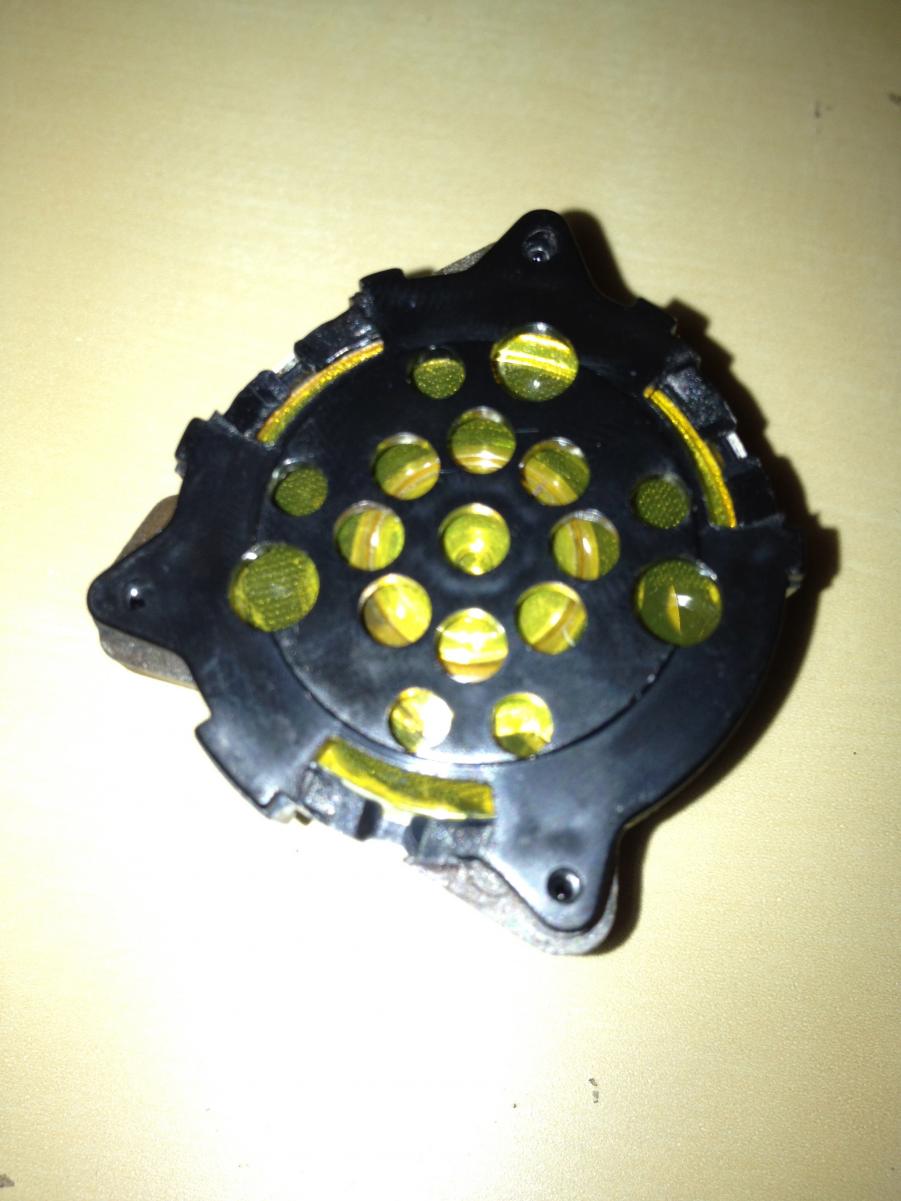

yea rip the speaker out. heres your culprit...

thanks ! but doesn't the speaker fulfill some function that might be needed? Thanks,
//David
Old Dec 8, 2011 | 01:29 PM
jonbonesjones's Avatar
Moderator
Joined: Aug 2011
Posts: 2,380
yea other annoying buzzers and dings that always come on with a warning light so just look down at your dash every so often
