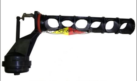

Sorry, I should have specified. It's the 30v engine. So it's on the front of the intake manifold instead of the rear. After a couple more hours of searching, I finally found the part number for it. It is 078 133 619. I already put it back on my car so I don't have a picture of it and the only one I found online shows it attached to the part that goes into the intake manifold. When you unbolt it, you just have what you see starting from the left up to the orange rubber gasket.

Hello. My name is Igor and I live in Brazil. I own a German B5.5 Audi A4 2.4 30v V6 (APS engine, most components are common to the 2.8 30v V6 AHA). Recently I started to have problems at low RPMs, and the car felt slow even at high RPMs, I checked the changeover mechanism and it was stuck. So, I decided to clean the changeover valve. The engine is running fine now, but I found some things that I would like to clarify. Is there a seal between that tapered washer and the changeover barrel? In mine there isn't any. Inside the intake there is only the barrel and the tapered washer, which in fact has a gap when looking at it in the barrel. Am I missing any parts? The only seal I have in my car is the one in the vaccum actuator (the red one in the picture that was posted). There are also some plastic seals in the barrel divisions. In fact mine looks exactly like the one in the picture, added the metal tapered washer at the intake end.
