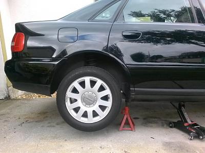

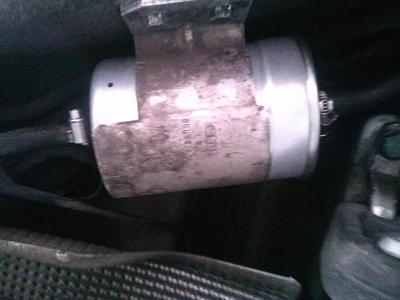

When I got home, I prepared for the worst. I jacked up the rear quarter of the car (w/jack stand)........and wouldn't you know it - I saw the filter mounted right up against the frame. Easily accessible, with only two 10mm bolts, 2 hoses and 2 hose clamps. I couldn't believe it.

Tools needed: 10mm wrench, 1/4" nut driver (or just a screwdriver). That's it! ...Have a Mason Jar (or the equivalent) handy - if you can.
The first pic shows the passenger side quarter raised up.
The second pic shows what you'll see once you lay down and slide under the car, right in front of the wheel (mounted to the frame).

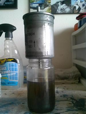

The Third Pic shows how I saved all of the gasoline lost in the process. My lawnmower is loving the premium fuel. lol
