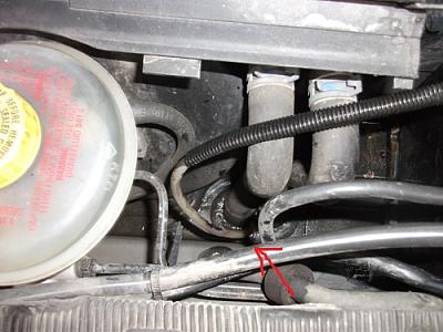

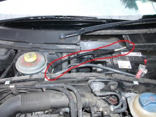

Ok 2000 1.8 NA Manual Petrol.
Having serious condensation problems inside so investigated today. My rain water channelling plastic covering (the one including the pollen filter covering) is seriously cracked, so obvious point of entry here. This I am going to try glue, but I think I will probably need to replace from a scrap yard.
My battery was sitting in a swimming pool. The two water drain valves (1 under battery and 1 under brake servo unit were clogged; so I poked my finger through them and all the water drained out. They are now just soft rubber holes, should I be worried that there is no "valve" or anything in them?
And Finally, this hose; Where should it be connected? What is it?
Any help with the hose in particular I would be extremely grateful for. Thanks.

So there should be valves in those two holes then? Mine are now empty.
Is the hose in my pictures just a battery vent hose or something else?

its not a valve its a rubber grommet filled with dirt, pull it out.
That looks like a battery vent hose in the pic
