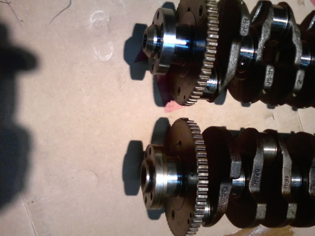

you cant really replace it anyways without removing the crank from the car.
that toothed gear around the end is the trigger gear, i have dropped one of those cranks (one im not using) off my workbench onto concrete and it left an impression of the teeth without damaging the wheel. unless some foreign object got in there while the engine was running or you were prying against it for some reason with a crowbar i dont see how you could have bent it.
you can take the sensor out and look thru the hole with a flashlight and see if the wheel is messed up. it could be as simple as a broken wire going to the sensor or the sensor not screwed in far enough to the block.
you said you rebuilt the motor last summer, what exactly did you do? it could also be possible that your a/c issue is not related to this problem at all.

Thanks for the reply and pics. My trigger wheel is different than that one. Mine is made out of stamped steel, angled at the end, and their are not teeth, just square holes punched out of the flat steel. Not as sturdy as the one looks like in the picture. I may have dropped the crank at some point and warped or bent the wheel and now I get an "Implausible signal" error
when I hook it up to Vag-com. The car starts and runs, and I have been driving it with the error for months now hoping I wouldn't have to pull the motor just for this.
When I reset the CEL using Vag-com, the A/C works momentarily, until the engine speed sensor error code reappears. This led me to believe that the AC requires a signal from the Engine speed sensor.
I tried to look through the hole, but was not able to get a good angle view due to ohter items in the bay.
