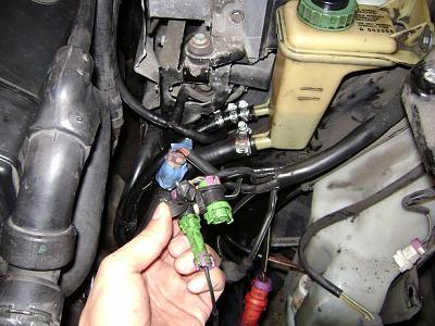

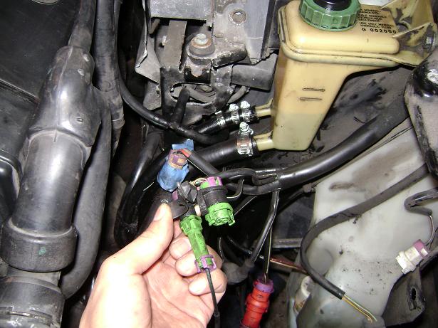

3) Lastly, I still have no clue what this mysterious green connector goes to (pic- fat green one, not the slender one). So I put the car back together with it unconnected, and everything ran fine... so far. I'm sure something will come up later... It should be so simple to find, but it's nowhere in plain sight. I feel like an idiot. If there are any 2.8 12v owners, could I ask you to take a quick look and tell me what it connects to? I can't find anything in ebahns or autozone repair manual.

I think that might be an 02 sensor connection.
Don't quote me on this, I'll have a look at mine in a minute.
