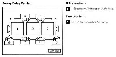

Here's a link that somewhat explains where it's at and I'm attaching a picture of the relay/fuse location...
It could be the SAI pump...or if the noise is ACTUALLY coming from the PS pump, it's not that bad and is not a hard fix/replacement....pentosin PS fluid (audi stuff) is really good generally about working in the cold, but mine has had it's problems in -20....

And yes, if you pull the fuse, the pump won't run and the noise should stop...unless it's the PS pump....and you are already throwing the code that may relate to the failure of the SAI pump....
The SAI pump is there to help the engine warm up faster for emissions, so if it's FREEZING cold out, it may run longer....

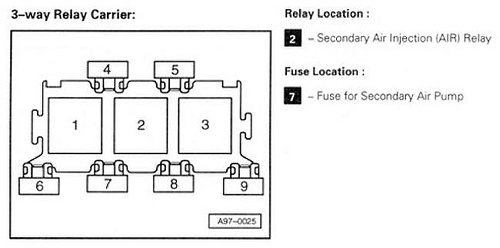

Quick question about the SAI - where is this relay and fuse location? Do I have to remove the ECU? I found this picture of the different module locations, and it seems to be number 16 that I'm looking for, but how do I access it?

Nevermind on the previous post!
Took the serpentine belt off and it ran like a charm. Still having issues with gas spraying out of the injectors when cold, but we've narrowed the noise problem definitely down to the PS pump. Taking it into the shop we bought the car from this weekend to get it swapped. Looking at around $120 for the pump (best price I found, shop guy said he'd look around and see if he could find anything better) and $120 for labor - there aren't many shops in town that will even touch Audi's, unfortunately....
While it's in we were going to get the injectors checked out, most likely replace the o-rings which they're asking $100 for. This seems a bit high to me(?) but at the same time we don't have any place indoors to work on it and I certainly don't want to be messing with the injectors outside in this weather...
When the serp was off, I could hear the SAI running, it was a nice low hum, but it shut off after a few second and a CEL came on (engine was not running, this was in accessory mode). The vacuum hoses for it seem to be pretty torn up, but at least it's better than if the motor or electrical had gone out...
