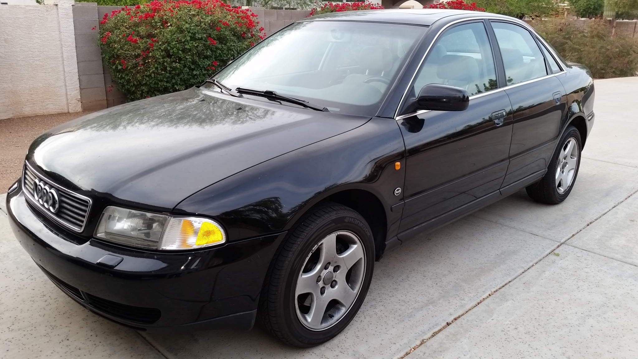

As I said I sure hope everything lasts without any issues and get many more miles out of the car. Thanks again and here is a pic of the daily driver.

Awesome! Looks good too, better than mine and mine's in pretty decent exterior shape.
Glad to be of help. I know the pain of having to work on a car that needs help in a ton of places and the satisfaction in getting all/most of it done.
Go out and enjoy her now!
