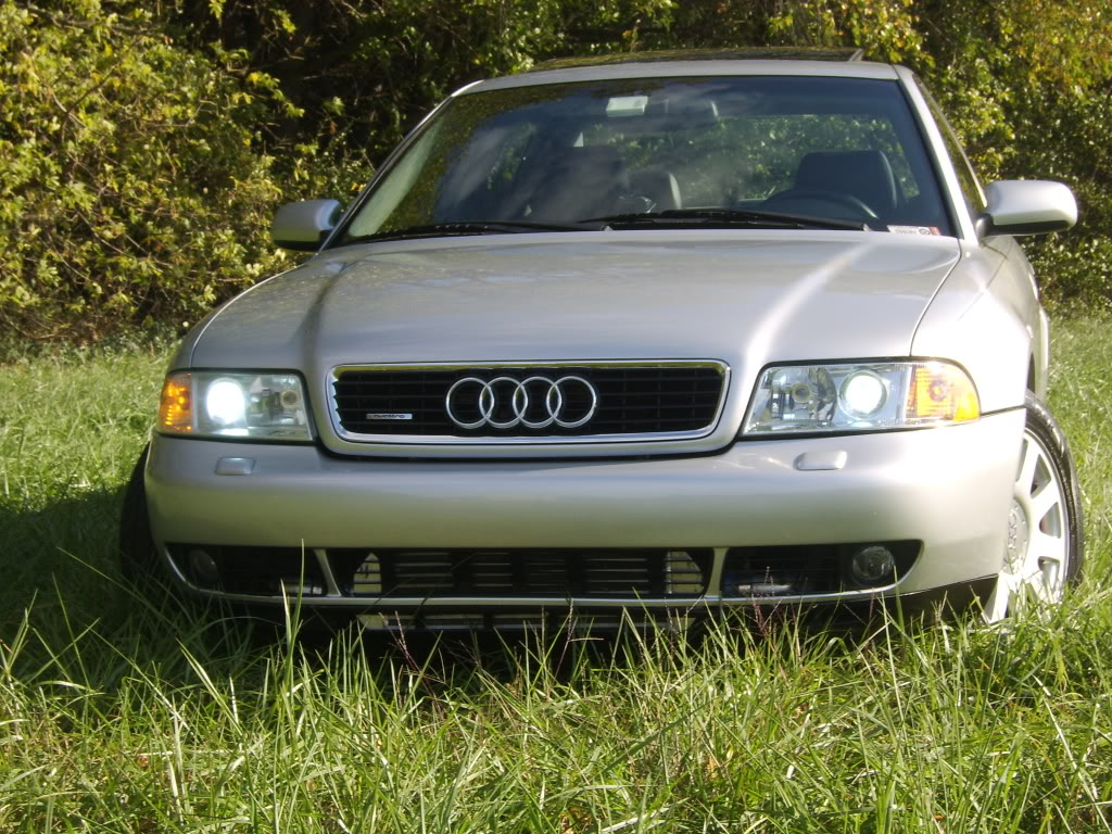

The one in the larger picture on top looks like an eBay job and the one in the sig picture is made by "ecode" according to the text in the picture. However that also looks like a B6 and doesn't appear to be in the US.

Why is the IC do low in the big picture? Yea that looks like a b6 and it's for sure not in the us haha

Oh ok. How can you tell just from looking at the picture, that it might be an eBay FMIC?

It's a small core, and that was prolly the easiest place to put it to avoid cutting the bumper re-bar and getting the most air through it. Lots of guys run theirs down there.
Can't be sure, but it looks to be about the size, shape, and shininess of this.

Understood, it's actually not that low lol. My mistake. I didn't realize it was sitting above the front valance. I thought it was below it . So it is possible to install it with out cutting the re bar, Do you have one? Any tips!?
