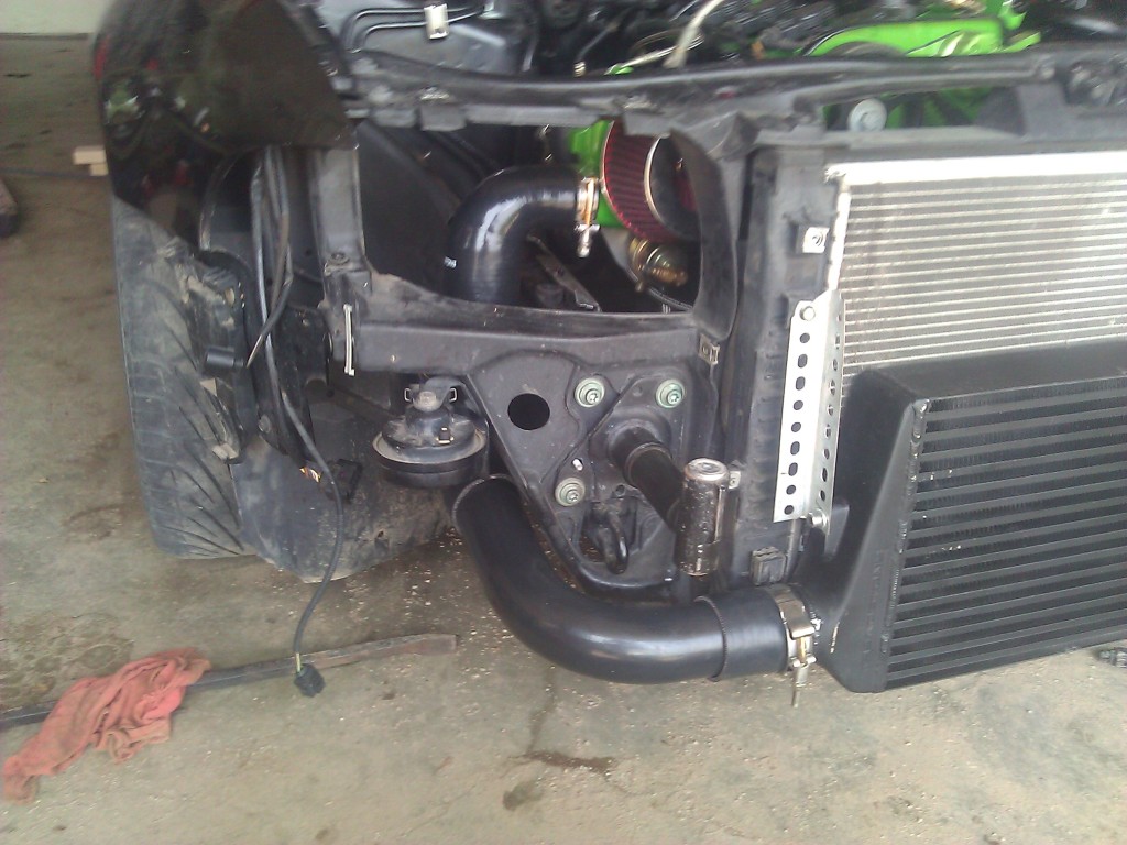

No reason to get hostile guys, as a general rule (that I just made up, but it is mostly accurate lol) if you are running stock rods then a eBay fmic will be fine. No reason to shell out 3-4x the amount for a more efficient brand name cooler if an eBay one won't change the intake temps much. The fmic in question is plenty for a k04, both metalman and I run similar fmics on our frankenturbo setups with no problems.
I'm not sure why Adam thinks that is a small fmic, it's about 2x the size of the stock smic, not to mention it is in direct airflow instead of whatever air makes it's way through the hole for the stock setup.

Because it is rather small. Not small compared to the stock one but small compared to most FMIC that you see. Yes costing more but that's obvious. I try to stay away from no name brands, that's me. And I shouldn't judge it since I've never used it but non well known names from eBay don't usually get very good vibes. Just a simple observation/thought. It seems many have had good luck with it and that's great I'm just saying I don't think I would use it but who knows. A FMIC wouldn't provide me any benefits at the moment anyways so it's not something I really need to think about.
Your car WOULD benefit from a FMIC. Heatsoak is even a problem even on a stock 1.8t, but chipped even more so. My cousin has a 00 1.8 with a FMIC Stage 1 K03 and had FAR LESS heatsoak than mine when I was Stage 1 for 5 years. Wouldn't provide you with any benefits? OMG, clueless.....

Anyway, back on topic......After side-by-side (net) comparisons to CXracing and Godspeed, I'm looking at the fastwayracer kit from Ebay I posted earlier in the thread for $212, down from $250 since it's on sale. Looks nice, and is comparable in #'s to the Godspeed & Co.....here it is again....comes with 2 yr warranty according to seller even though it isn't in the listing. I'll be keeping the email via Ebay for records just in-case.

AGAIN, you don't know what you're talking about, and man this is becoming comical. Not a normal size? Incorrect, other than the 2.25" inlet/outlet, the VAST majority of FMIC's are close to that size for what someone would need for a B5 k03/k04 setup. That's, if you want it to fit properly without hacking away everything. Ok, what's the MOST common size then? Where did you find your information that supports whatever that common size is? Heck, I even posted 5 or so links from Ebay of intercoolers "designed" to fit the B5. All of them other than the ONE 2.25 inlet/outlet were nearly identical in size (27x6x2.5). This size is the best suited for our cars, or VERY close to it. But apparently, there's something better because you "claim" it's not the most common right?

Secondly, yes, Ebay brand FMIC's are shittier than good ones. They are not as dense and sometimes tube and fin versus bar and plate style. However, one of those CX Racing intercoolers will work just dandy for a k03/k04.
Heatsoak is NOT an issue with a daily driven b5. It just isn't. Now, if it is 100 degrees out and you are enjoying a spirited drive, yes, a FMIC will be a benefit. Driving down the freeway? No. Auto-xing? Yes, get a FMIC.
As for piping, keep the warm side a little bigger than the cooled side if you want since it is denser. I think ideal on a stock turbo is 2.25 hotside, 2 cold side since it is denser and it helps support velocity.

Really? I've always thought it would more beneficial to have a larger cold side. Yes the air is denser on the cold side but the air is less compressed as it just went through the inter cooler. Therefore making it more important to have a larger cold side rather than a larger hot side where the air is fully compressed.

In theory, of course simply driving down the freeway wouldn't require an upgraded intercooler, but lets be honest, who does that all the time? We all upgrade our cars for more power to drive them fast, maybe not 100% of the time, but certainly enough to want MORE power with the intention of getting on it during acceleration or while cruising. Really, even a GT wouldn't need a FMIC if we're talking about simply cruising down the freeway, right? With that said, even a chipped K03 would benefit from an FMIC, and it doesn't have to be 100 degrees OR driven hard 100% of the time to feel the difference. Think about it, even a Stage 1 boosts over double what it does stock, so of course IAT's are going to be high enough to where a FMIC will be beneficial. I could easily tell the difference between my buddy's/cousin's car and mine, so that's what I'm going off of.

Looks like a decent kit for the money, I don't know why but the picture makes that core look huge; The dimensions look fine though. Did you email the seller to see if they offer 2" piping? On a k04 having anything larger than 2" would just increase turbo lag with no real benefits.
