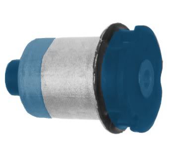

Here's how the bushing sits in the axle beam:
Attachment 35850
Where the gray part is the part you cannot see because it is enclosed by the axle beam.
First will be cutting the ends off with a sawz-all, specifically the blue shaded parts:
Attachment 35851
This makes it so that the aluminum inner core will now only be attached to the bushing itself by the internal rubber webbing.

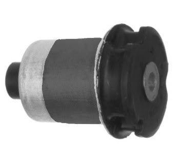

BTW, here is the cheapest guide bushing you will find:
http://www.autohausaz.com/search/pro...FQoTbAod6APOEA
2 are required, 1 per side. These are made by Meyle so I would expect the quality to be half-way decent.

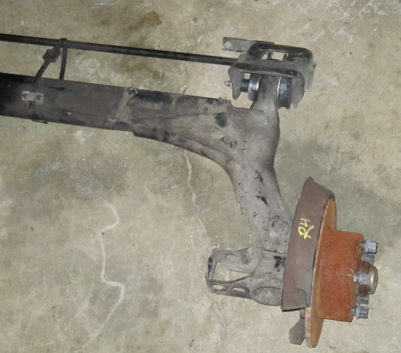

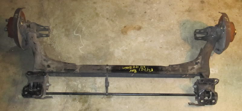

Attachment 35765
Just for reference, this is the completed axle beam (with new guide bushings installed) except for a couple brackets that hold the brake lines and e-brake cables, and the rest of the brakes. I will be reusing my brake rotors...
The junkyard marked RH and LH which is left-hand and right-hand, obviously. It's a good reference.

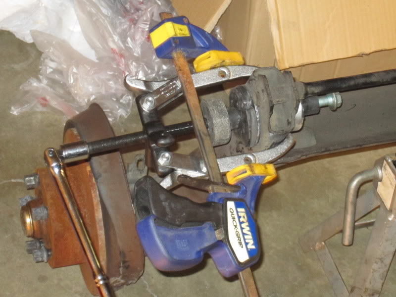

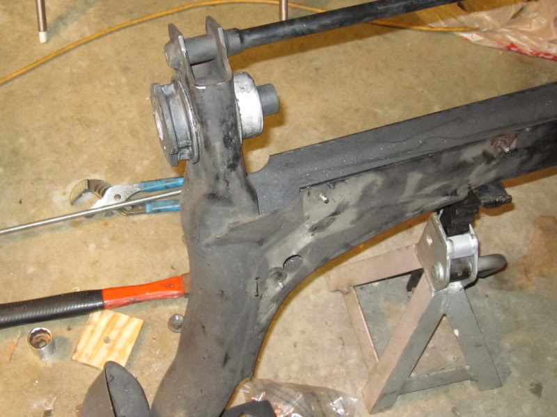

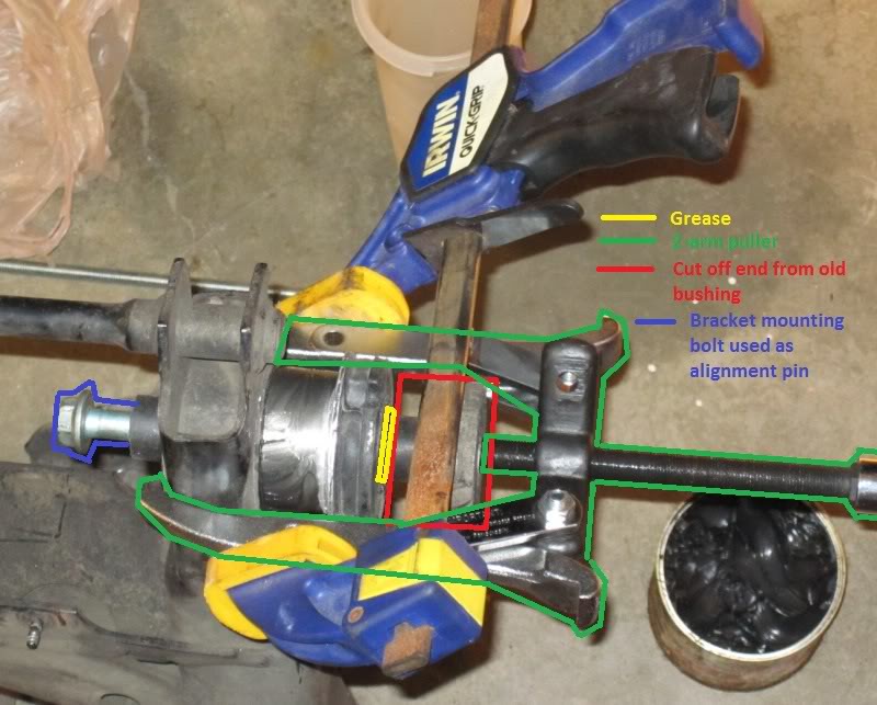

This is the bushing installed hand-tight, with my installation fixture:
Attachment 35768

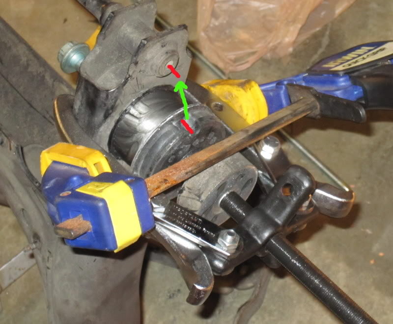

Keep in mind that the bushing does need to be installed with the proper orientation; the deeper notch needs to be closest to the reinforcement bar, and it can kinda be seen in the pictures.
Attachment 35769

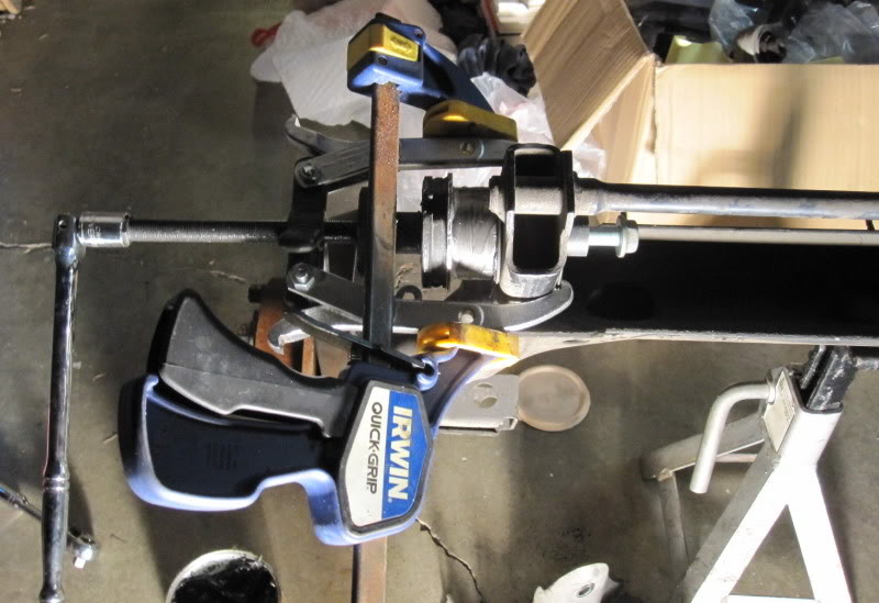

Essentially it's a 2-arm puller (it's actually a 2 or 3 arm puller) converted for pushing duties. Part of the cut up old bushing is used as an interface between the puller screw end and the new bushing, with some grease between the cut off piece and new bushing (since the cut off piece will be spinning with the screw on the puller directly against the new bushing). There is also the blue/yellow clamp there to ensure that the arms of the puller won't fling off and hit me in the face. This should help clarify:
Attachment 35770
Also, the bushings won't slide in without help. The first bushing I did took forever. Turns out freezing the bushing with dry ice and heating the axle beam with a torch doesn't help. I applied bearing grease on the bushing, and inside the axle beam where the bushing goes. On the other side, I also slightly reduced the diameter of the bushing by chucking it into my drill press and taking a file/sand paper to it. This one is still an extremely tight fit, and it went in MUCH easier than the first one did.
The bushing part-way in:
Attachment 35771
And the bushing pushed in completely:
http://img.photobucket.com/albums/v1...m/IMG_0603.jpg
Attachment 35772

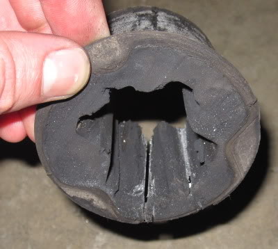

MetalMan Nov 7, 2010 07:24 PM
4 Attachment(s)

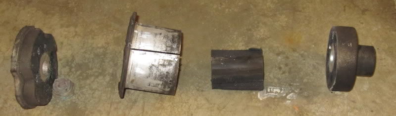

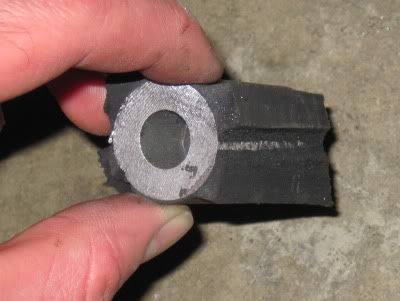

And for reference, this is what the old bushing looks like from being cut up, to remove it from the axle beam:
Attachment 35761
Attachment 35762Attachment 35763
Attachment 35764
