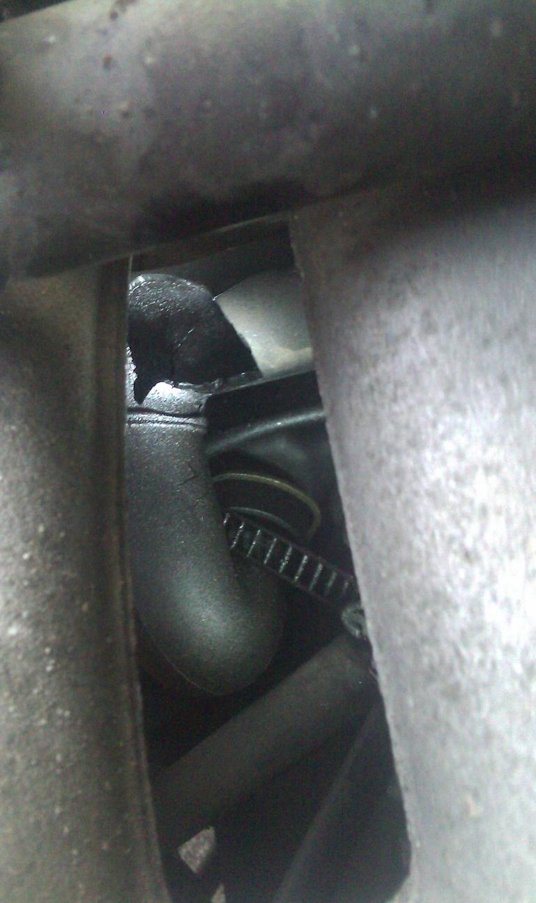

thats the picture of the hole, hope fixing that fixes everything!

Holy ****! yeah fix that!

Wow I can't believe it's not the ICM. Sorry about that. Move on to a shop that specializes in VW and Audi if the following fails- Although people replace them sometimes for preventative maintenance, fuel filters are never the cause of any issues with these cars... The shop is just taking guesses at this point. Worse guesses than we are. A clogged air filter won't make it misfire or stutter. That huge hole under the manifold actually wont make it stutter, either. But it should be fixed. It's just for egr flow which may affect your mpg slightly. The last thing to check is your maf. Unplug it and drive it around and see what happens. If it improves then thats your problem. A bad maf can cause a mix of issues including misfires. Just don't drive around much with it unplugged. Also do you know if your ecu is chipped? If you're not sure, regap your plugs to .030 and see what happens. That is a safe gap for stock or chipped. Stock gapping would be too large if it's chipped. You DID adjust the gap on them before you put them in, right?
