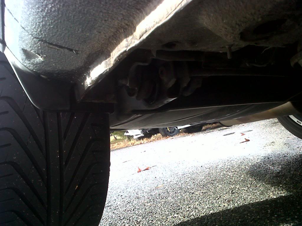

The rear end of my car feels like its walking around on me left to right. I see which bushing is broken on the right rear right infront of the tire. i just am completely lost as to what its called and need to know what to order. maybe a lateral link? im pretty sure its not the subframe bushing. Its moving a lot and i want to get something a lot more solid any recomendations?
Attachment 27931
Attachment 27932

can you back the picture up so we can see the area its in and not just the bushing. Take a pic of the rear of the car and circle the bushing location.
shutupnshift04 Nov 13, 2012 03:01 PM
1 Attachment(s)
Attachment 27930
thats the view of the passenger side looking towards the rear of the car
shutupnshift04 Nov 13, 2012 03:08 PM
1 Attachment(s)
Attachment 27929

BaseDrifter Nov 13, 2012 08:12 PM
Looks like the beam guide.
https://www.audiforums.com/forum/b5-...cement-159123/
BaseDrifter Nov 13, 2012 08:14 PM
Yep, confirming my own post here. Has to be the rear axle beam guide. :D
http://www.autohausaz.com/search/pro...FQoTbAod6APOEA
