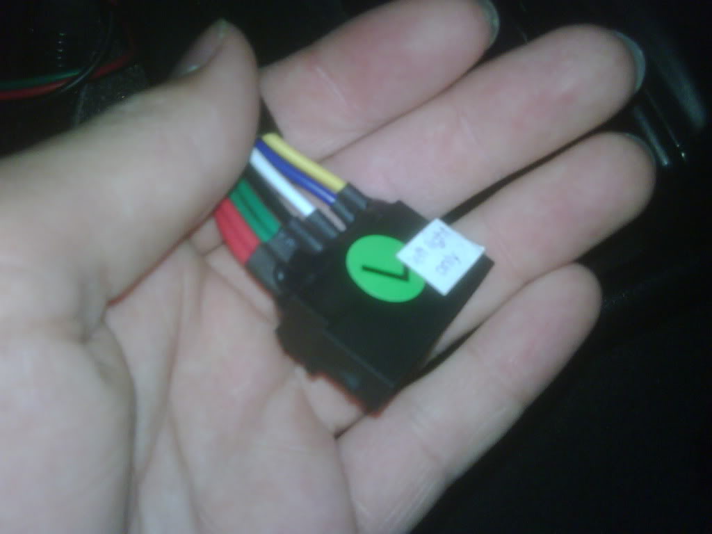

I tried both tail lights installed, and something different did happen
When i went in reverse, the blinker light lit up
when i turned my blinker on, the reverse light blinked.
im assuming that means i need to switch some wires. But they look like they are melted into place or something, take a look.

They aren't melted, there are little black clips holding them into place.
Read the DIY I posted!

these are different tail lights, i see no black clip of any kind on these

Any way you can take better pictures of both sides of the black plug?

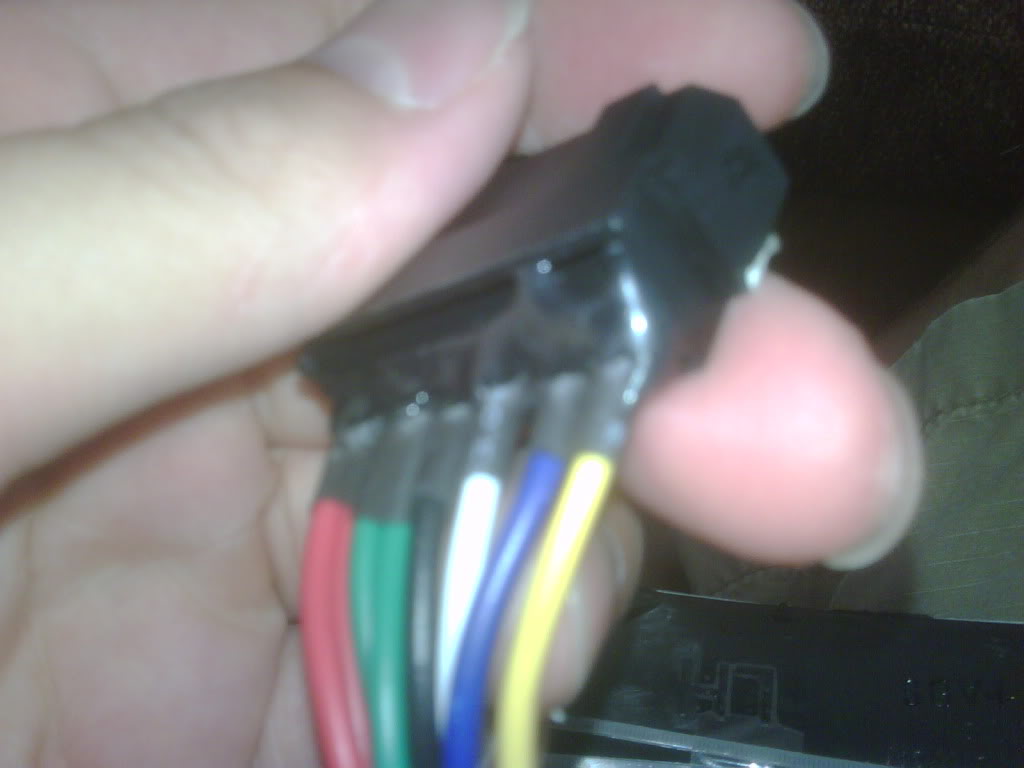

these are the best i can get on my phone

That picture is of the LED's plug.
You need to change the plugs on the Audi's loom plug, not on the LED's plug.
The Mod link that Nick posted is for the Audi loom plug.
Either that, or you cut & solder the wires on the LED lights side. If you don't want to alter the factory plug, that's your only alternative - and if your confident with a soldering iron & wiring shrink wrap, it's pretty simple to do.
All you need to do is identify the Earth/Brake/Fog/Reverse/Indicator wires - a multimeter or test light is perfect for the job - on each plug & alter one side or the other to suit.
The loom wires on both sides of the car should be colour coded the same, with the indicators being the only different colour (from side to side), so once you identified the colours on one side of the car, it should be relatively simple to identify them on the other side.
