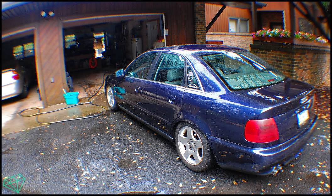

I still have my all red ones in

yeah those look sick. I think i'm gonna try masking off the back up lense when i spray mine. Should be an adventure lol
Is your rear deck paisley? Epic win.
