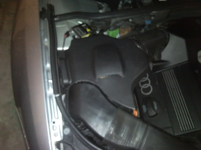

Regarding your second question, the MAF will be inline with the intake in between the airbox and the throttle body. AWM is the 1.8T motor and I have a V6, but just to give you a ballpark, here's a pic of my motor:
The MAF is underneath that plastic shield that's shaped like Texas; you can just see the shiny clamp on the right side there. That shield pops right off, and you'll be able to get the MAF out from there.
Last question, before you buy a new MAF, you might try cleaning yours. Its possible it may just be crusty.
