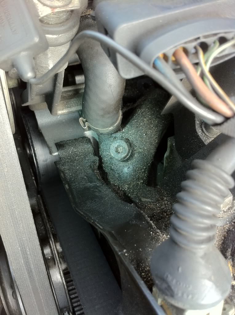

Yes, of course it is! I don't know why I couldn't find it earlier. I found it on Sunday when I did the heater core flush, and the screw was very easy to find.
That being said, mine was kind of dirty and I couldn't tell which kind of head it had, so I tried a T30 bit, and that got stuck in there while I was trying to open the bleeder screw. So I stopped trying and had to yank the bit out of there with a pliers.
Anyway, since I already had flow thru the core, I left well enough alone and didn't try a hex bit on the bleeder screw. Ian, do you know by chance which bit should fit? Torx or Hex?
I spoke to my Audi mechanic today, and he said that since I'm getting good heat at high revs and little heat at idle, that's a definite sign of more air in the system somewhere. He told me to keep burping it and I'll eventually get good heat at idle.
He also said that the secondary coolant pump is only used when you turn the engine off. It turns on when the engine turns off, and circulates coolant through the system to keep the engine from overheating. So it's a non-factor in producing heat when the engine is running.
