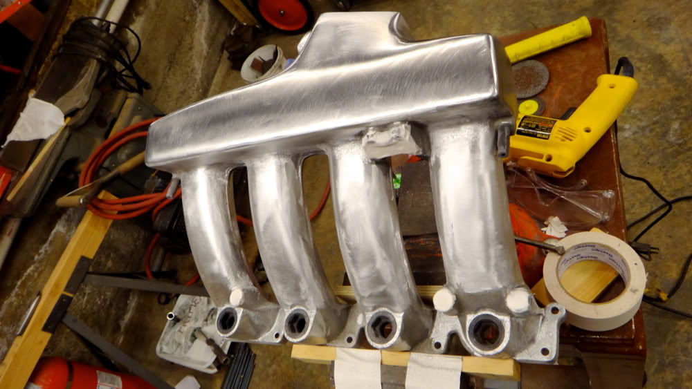

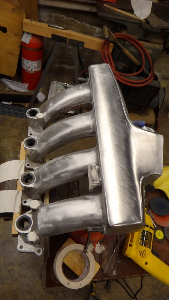

After doing nearly nothing with my hands during my 9 months in the Czech Republic, I've been itching to work on a project.
So why not get back to polishing that intake manifold I purchased 2 years ago?

I've still got a decent amount of work to do, lots of scratches to still take out. I need to get into the small areas around the manifold flange and around the TB area as well.
Most people opt not to polish the flange or the backside, but I've got time to kill so why the hell not. I probably won't put as much work into the backside, but I've already gone over it once.
More pictures to come soon.
(The pictures look fine on my monitor, but let me know if they are too large to view easily and I'll resize them.)

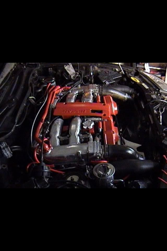

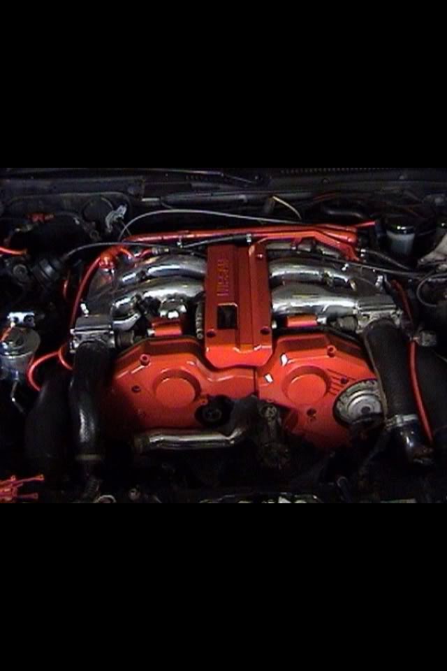

I don't, but when I polished the manifold on my 300ZX, I spent about 75 hours doing the whole thing by hand with a mouse sander. Tedious as hell but worth it. I used several grits of sandpaper, followed with scouring pads and steel wool, then the rouge and white polish, and it came out looking ****. You can do the same and you'll be very happy with the results. Sorry about the crappy pics - had a RAZR phone back then.
