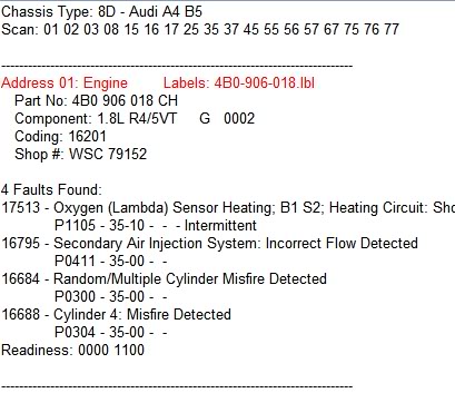

Luckily I have VAGCOM and am able to supply this to aid in the diagnosis:

Just got back from the test drive and sure enough the misfire was still there with all the same symptoms. When I got back, I pulled up my fault codes and found that it was cylinder #3 this time (the one with #4's old coil pack). So this means that it is, without a doubt, the coil pack, right?
