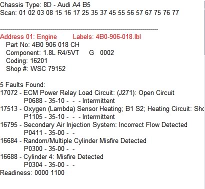

I got one new coil pack from Napa and switched it with the defective one. Now cylinder #4 is the one misfiring again. Should I just go with four new OEM coil packs from NAPA? or is there a more reliable type out there? I don't think I have the upgraded S4 ones, because mine don't bolt to the valve cover.
Is it possible that my brand new O2 sensor is broken? How should I check it? What else could be the problem?
Here are the latest fault codes. I think some of them may only be related to the battery being disconnected though. Let me know what you guys think. I'm starting to get frustrated here.

Old Jun 13, 2009 | 10:57 PM
  #18
Tweaked's Avatar
Joined: May 2008
Posts: 1,900
From: CT
Originally Posted by a2thy
For the coil packs, what do you mean by "the secondary"? and are there better coil packs I can use to replace them (aftermarket or OEM)?
OEM only. Order from ECS or your local Audi dealer. I meant the "secondary spark," or second "stage." Normally, this is the function of the ICM, but it was integrated into the individual packs on AWM and later engine codes (01 and up).
Also the clips for the coil pack wire connectors are all cracked, can I get some from a junkyard and just splice them on to replace them?
Guaranteed, this is your issue, if not at least contributing to it. The connectors really need to be tight to avoid misfires. You can get the connectors from your Local Audi dealer parts department. They are fairly easy to replace the connectors. DO NOT splice them in; the connectors are designed to remove the leads and replace the connector. You can remove them from any AWM code engine, years 01-02, if I recall correctly.
Old Jun 13, 2009 | 11:47 PM
