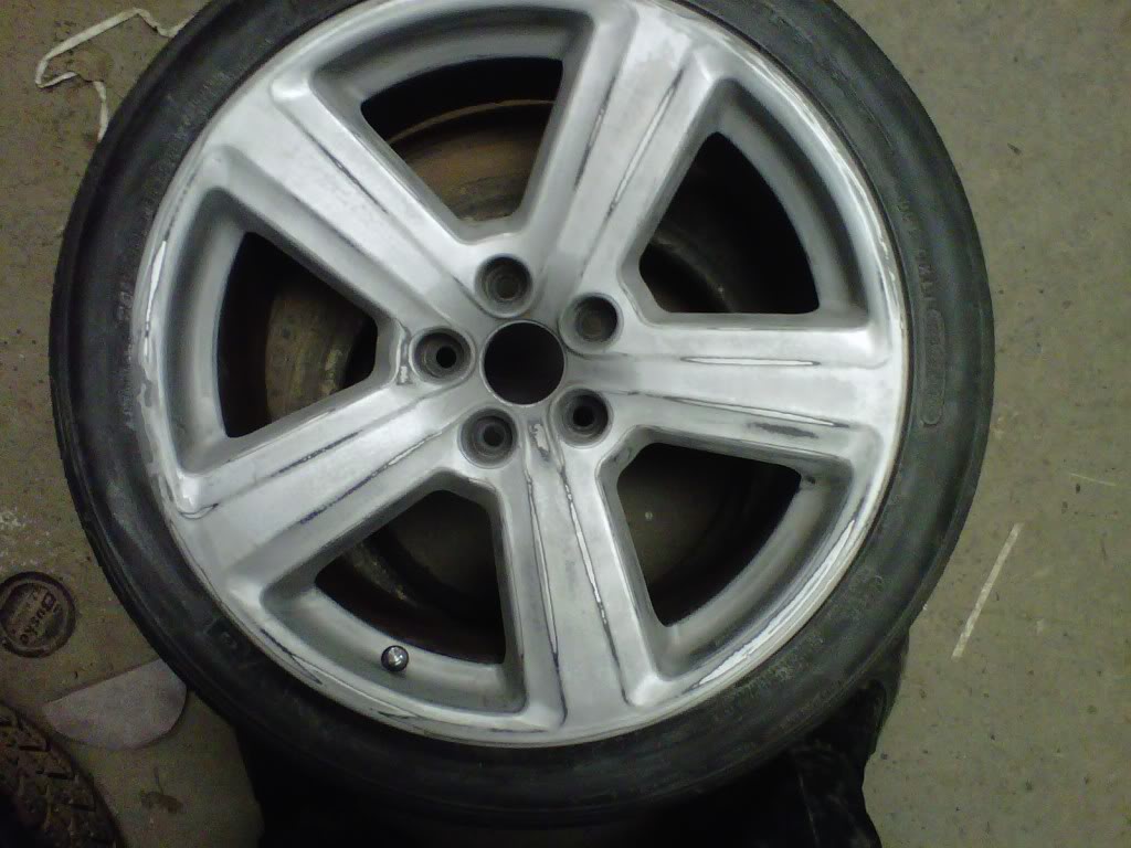

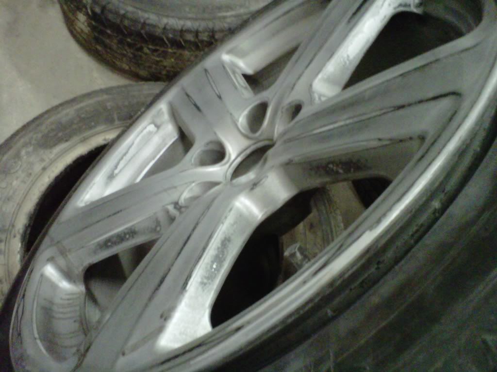

So a little over a month ago I snagged some RS6 reps in good shape, but not good enough for me. Not to sound snobby, I'm just very attentive to detail, and I wanted them darker. I contacted my uncle, who is a professional body-dude. We started by taking some 180 grit to all the bad bits of curb rash. We pretty much only used the 180 around the edge.
After we sanded down some rash

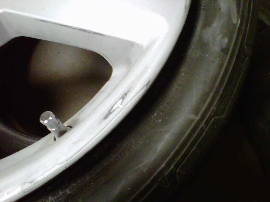

After that, we went over all those spots, this time in much longer strokes, with 320 grit, to smooth it out. We also took the 320 to any other imperfections. Any little dings or anything.

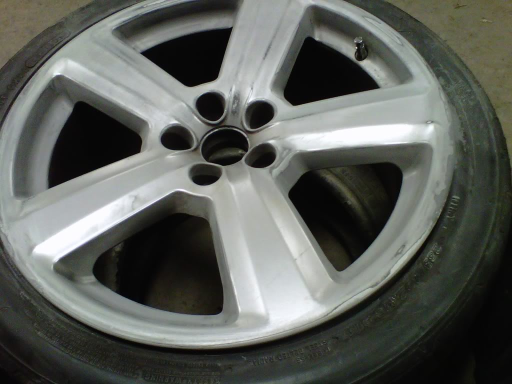

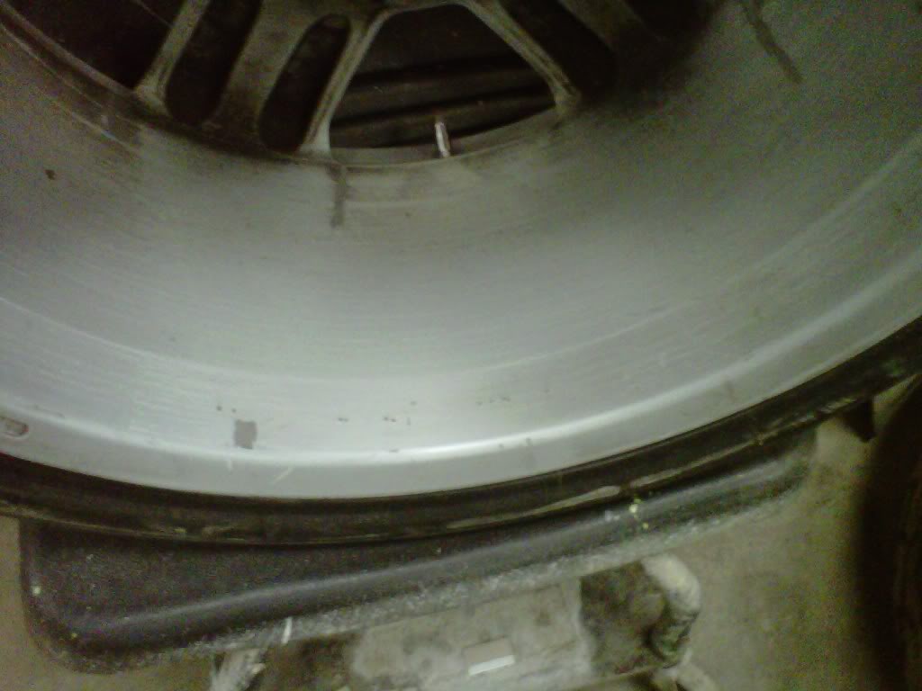

After that, we went over the entire surface with 400, then 600. Pix of that

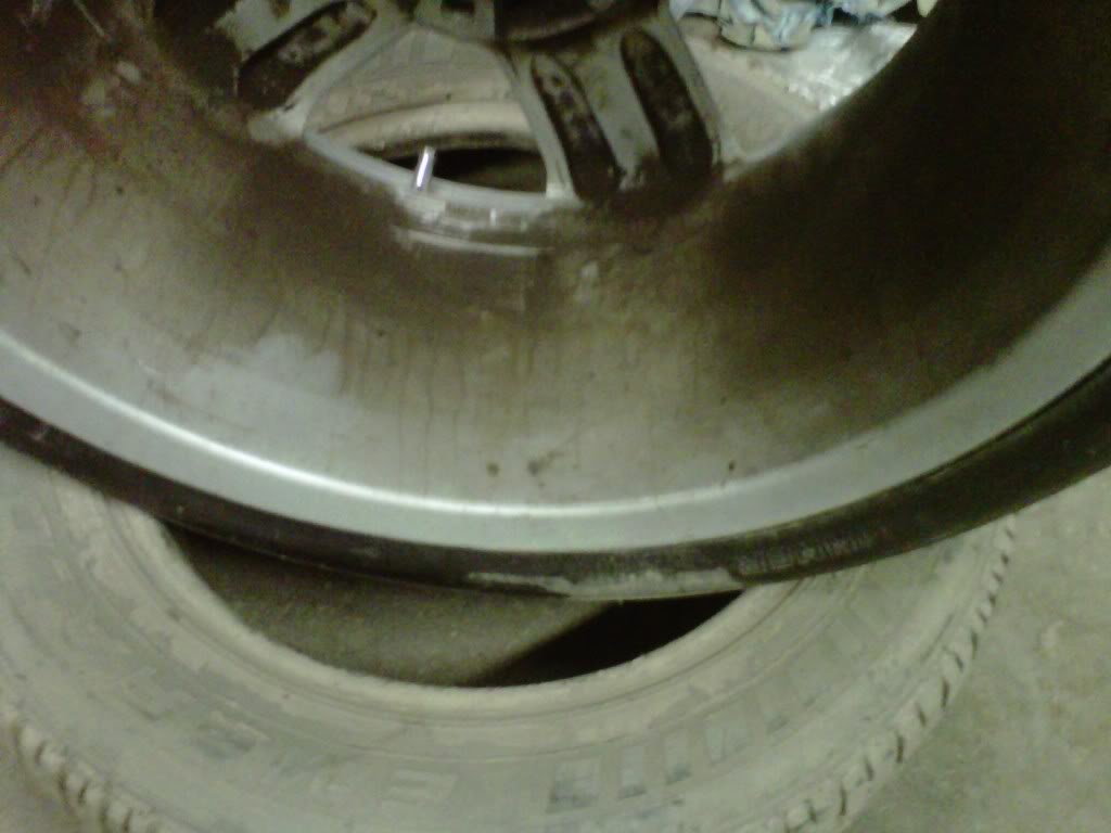

Then I decided to paint the insides of the wheels flat black, for a nice contrast, and I think it will look better than the dirty aluminum. So we cleaned the **** out of the insides. We hit it first with the 400 grit, just to get the hard dirt off. Then we hit it when a red scuff pad, scrubbed it with thinner, then wiped it down with Prep-All.
Before

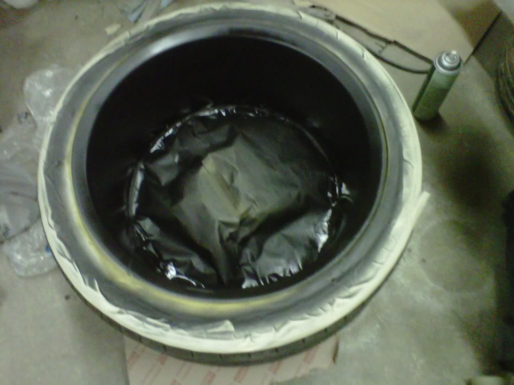

We masked off the face of the wheel to be safe so paint wouldn't get out

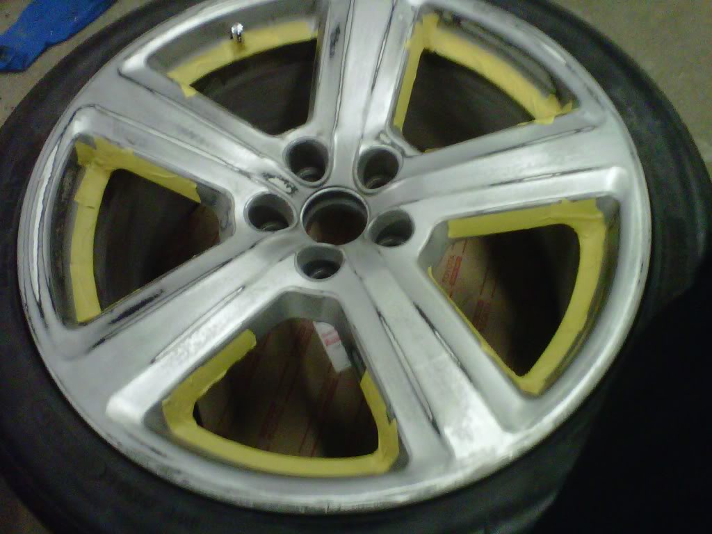

We then papered and taped the inside so we wouldn't get paint on the face, and for a nice line

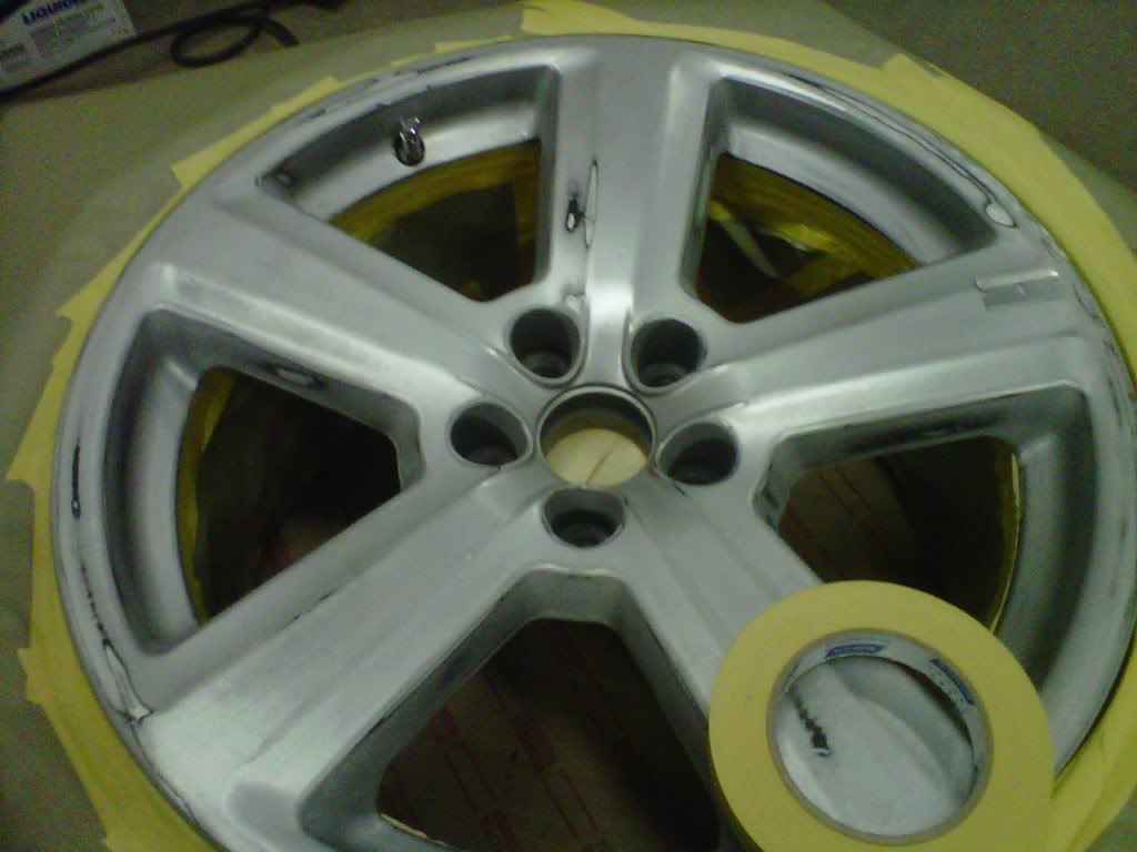

I don't have any pix yet of just the painted wheel without the tape. But yeah. We started masking off to paint the face. Much more of a pain in the ***.
I'll upload more pix later.
