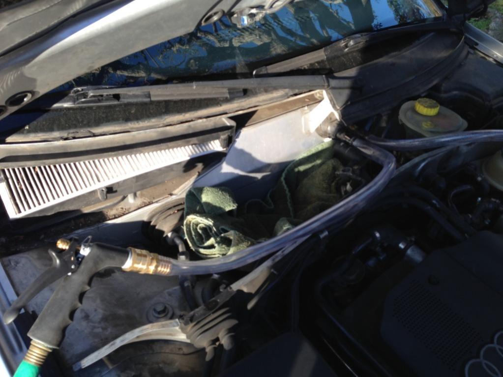

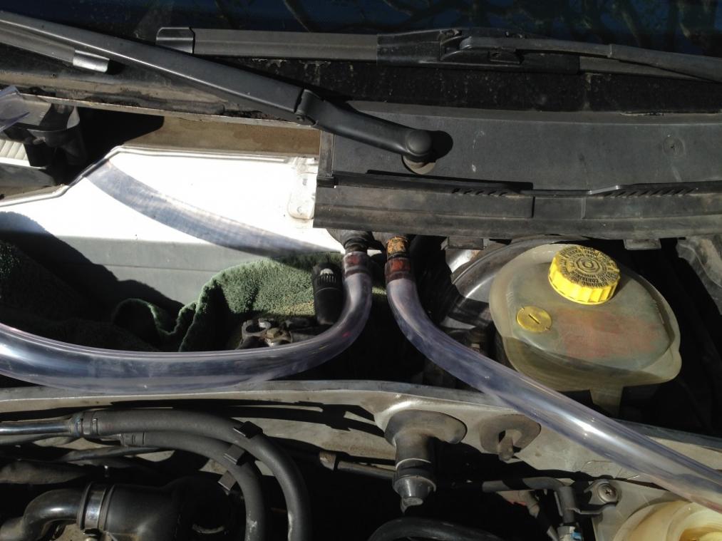

You don't need to drain the radiator. You can just disconnect the input/output hoses and flush the core directly while leaving the rest of the coolant in the engine/radiator alone. Then when you are done you need to reconnect both hoses, but leave the output hose only partially on so that the drain hole on top of it is open. Then add more coolant to the reservoir and run the engine for a while until coolant starts dribbling out of the drain hole. In other words you are trying to get rid of air in the system. It might take a while to fully drain. In fact I think after I did the flush I did another air draining session the following day until I was sure coolant was coming out of the hole.

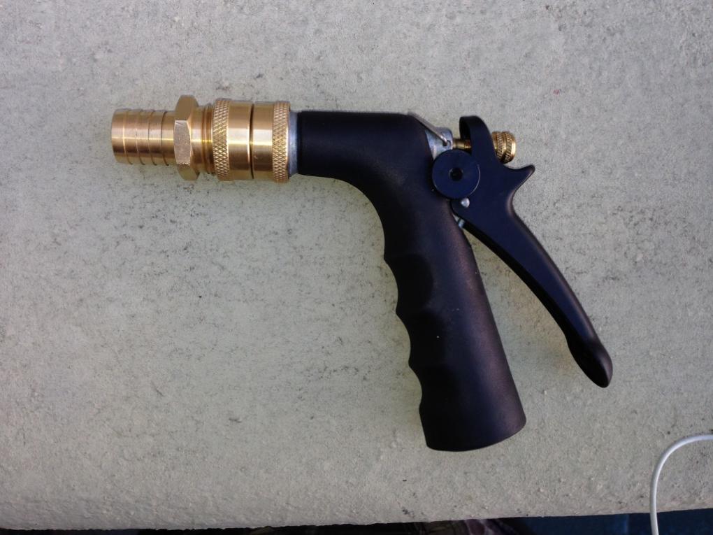

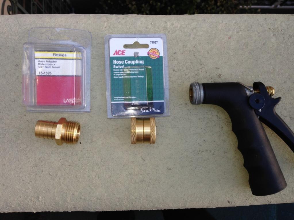

As for the flush, I've been meaning to post these pics I took last year. My tips are:
- Buy a looong stretch of 3/4 inch CLEAR tubing. It really, really helps for it to be clear so that you can be prepared for the bursts of crap that will come out of the tubes.
- Have a LARGE bucket for the output hose.
- Cut the tubing into two sections, one much longer for the output which will go into a bucket.
- Create a hose gun using the parts (or similar) in the pictures.
- Flush repeatedly in BOTH directions (swap hoses) until no more gunk comes out. I think I went back and forth at least 4 or 5 flushes. Took at least 30-45 minutes.
- Helps a lot to have a friend if possible. Lots of hose and bucket wrangling.
Doing this completely worked for me. I had no heat for like 2 years and ever since doing this I've been 90% back to normal. (Will never be 100% without a heater core replacement, which is a nightmare job.)
