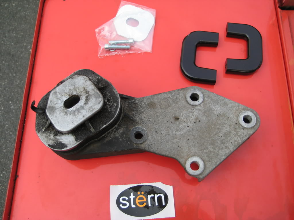

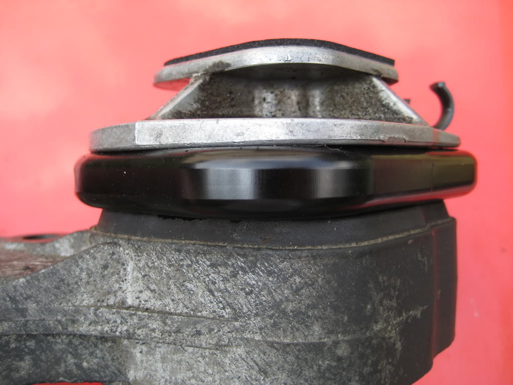

The Stern Differential Power Ring is very easy to install and it mounts between the top of the mount bushing and the metal mount itself. Essentially, it makes it a solid mount. You will need a new diff mount if the rubber is torn. http://shop.dthaus.com/product.sc?ca...0&productId=11
DTH carries it. I highly recommend this product cobined with Stern rear diff bushings.
BUT.... this did not solve my clunk. I have been driving on a beat clutch for over 5K miles and too long to admit on a bad wheel bearing. On top of that, my front end is still ugly from my deer attack, the interior is like a sandbox, and the outside is constantly covered in snow, ice, or mud. New England has been rough this winter and my poor A4 is in pain! I'm STILL working on the clunk, there is just an epic to-do list for my car, and my upcoming wedding to drive myself crazy over it.
