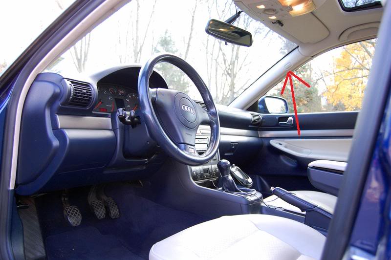

Jc61990's Avatar
Posts: 3,326
From: Long Island, New York
easiest way to tell is if the word AIRBAG is embossed in the fabric..

Old Dec 10, 2008 | 09:31 PM
littlewood's Avatar
Joined: Nov 2008
Posts: 25
From: Rapid City, SD
Ok, no airbag logo... good deal! I don't enjoy the idea of losing an eye to being stupid! So now that I know my car won't blow up on me when I take it off, does the a-pillar just pop off?
