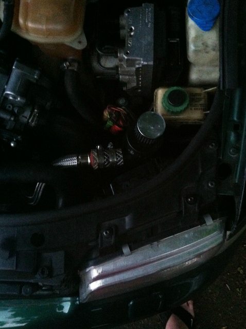

Ok so here's my setup, i bought nylon/ braided steel piping down at lowes and kind ghetto rigged it with some piping i had laying around but so far it hasn't collapsed and i doubt it will.
Maybe its just the placebo affect but my car feels tremendously better at idle especially and it feels happy with me now.
