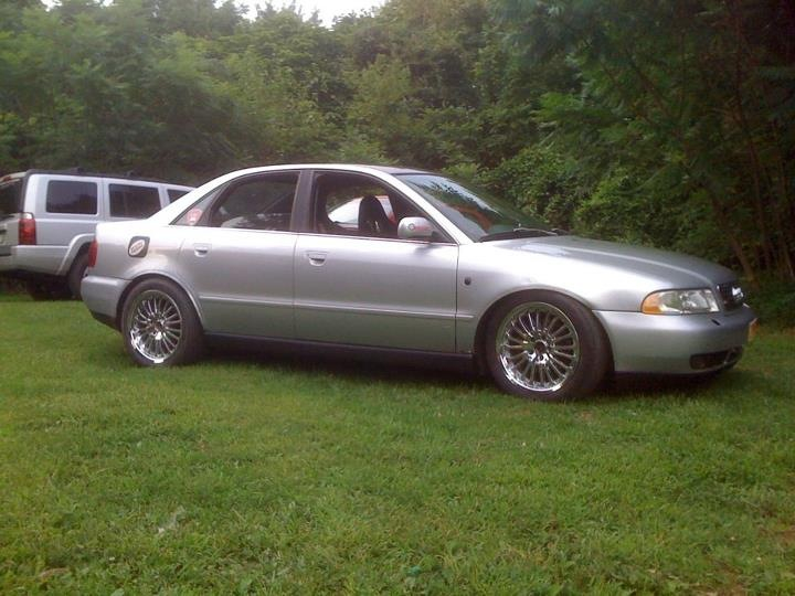

Okay so I got my tire/Clearence issue figured out. So current wheel tire set up..18x8 et48 msw type 16s with 20mm spacers... I'm running 235/40/18 falken azensis in the rear and a 215/40/18 toyo proxe up front. No rub, car feels great. Got my suspension dialed in to the point I can drive the car fast again.
Getting use to starting slide before the corner instead of mid corner like awd. Feels good, power on feels great. Still adjusting to turn in though.

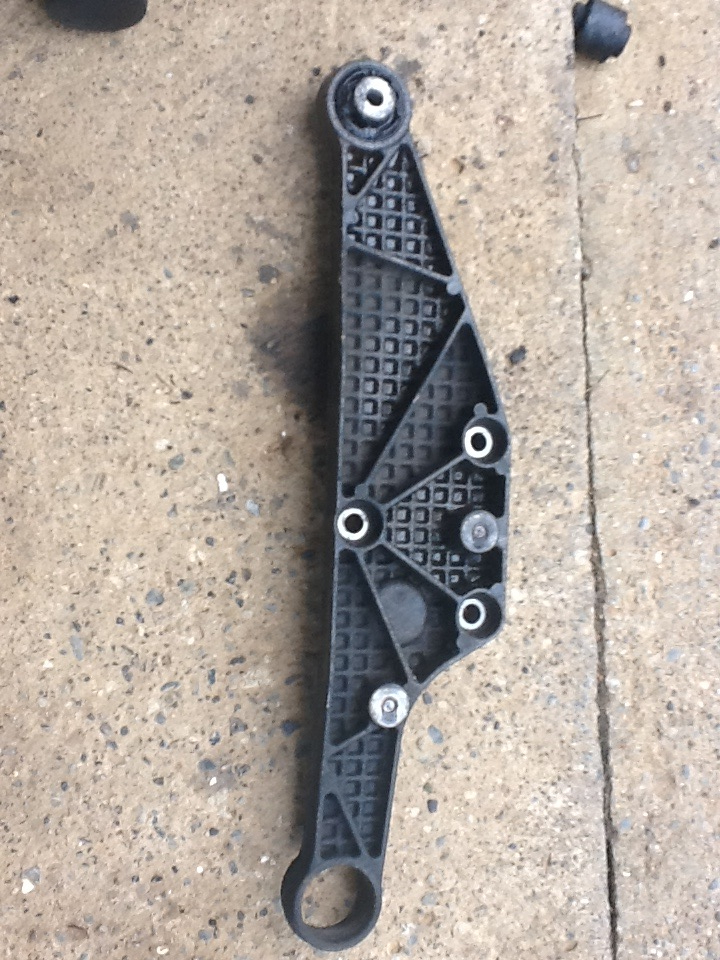

So I was trying to press out diff carrier bushings and the on side was stuck.
Wound up breaking the carrier trying to pop it out with a press.

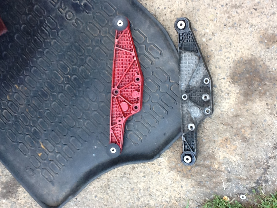

No haven't thought about BMW parts. I'm working on a 200cs rear diff with the air locker. Been working on getting the drivetrain stabilized. Got my rear diff carrier bushings in and installed
They make a world of difference. Power on feels better corner exits feel a little better.
Still get a little clunk on 1st -2nd shifts.
But it feels good deff worth the 52$
If your doing your carrier bushings I would just buy a second carrier press out old bushings install new and than swap the carriers. Makes life a million times easier. That and I have a spare now invade I do brake one
