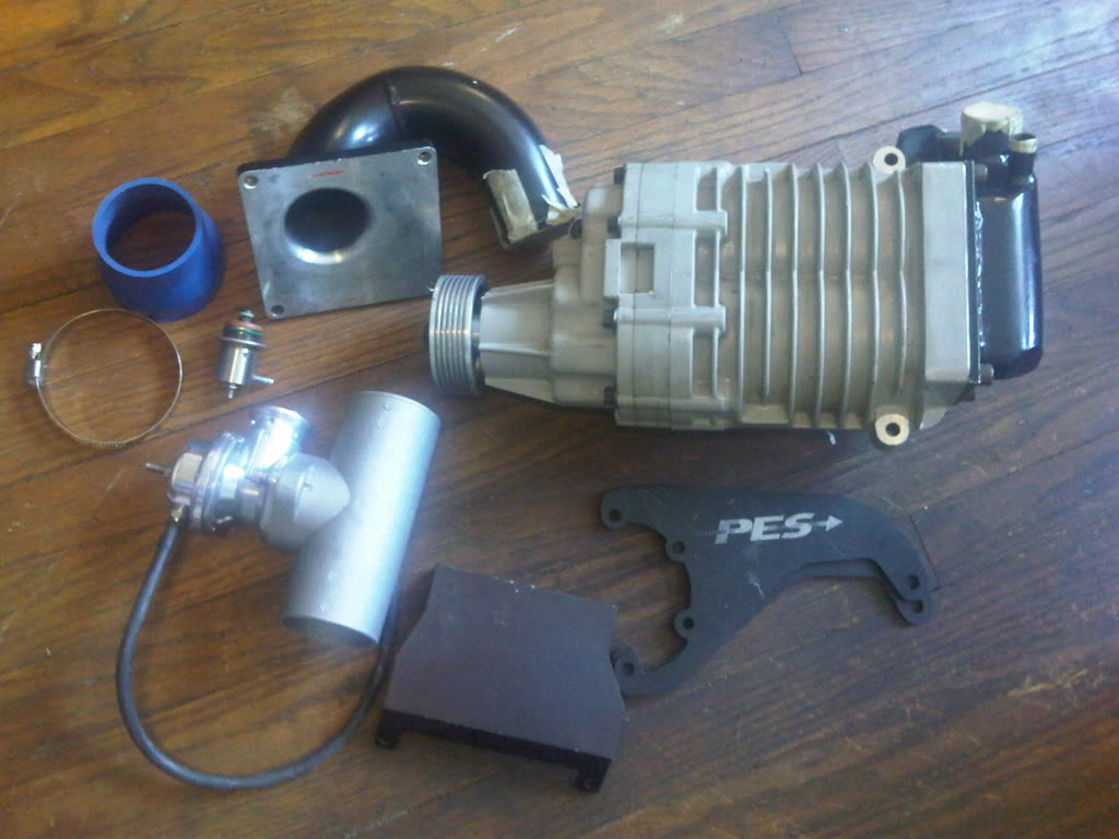

I figure I'll post my build and it's status for you guys to drool over =P
So it started with getting some free parts from A4_effort about a year ago. At that point I had some injectors, the throttle body inlet pipe, AFPR, and a few other odds and ends.
About 2 months ago I found almost all of the rest of the parts I needed from a member of SCAudi.com I purchased a G1 supercharger, the intake plenum, and charge pipe for the G1, and all of the brackets. I now had about $350 into the setup =D
I then contacted 4 Rings on SCAudi.com and he was able to hook me up with the other pulley I needed for about 40 bux. Still under $400!!!
Ok so at this point I needed a belt, tune, and the by pass valve hose. I bought a new belt form NAPA for $16, normally it's like $50 but I work for my parents at a Euro mechanic shop here in town and get discounts everywhere.
Sweet just over $400!!! Well this is where I am at now.. Still looking for a tune but I have an idea of how to get the hose I need. The tune I'm not sure yet, I am waiting on a call back and hoping I get it with some good news.
In the meantime I have also started getting the car ready for it. I have 160k miles on the car and plan on installing it on the high mile engine. The engine feels healthy and I'm doing the proper maintenance.

Well since I am on a budget I am trying to get the PES tune which was actually made by GIAC back in the day.
The injectors I believe are stock S4 injectors.
