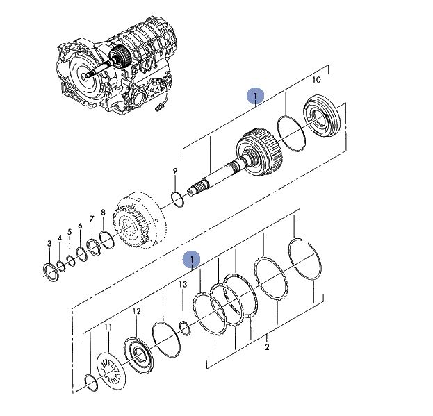

Jeff-AudiUSAParts Sep 5, 2012 02:38 PM
1 Attachment(s)
That is between 465.00-502.20 depending on the trans code you have in your car. Looks like it comes with the piston #10 and that large circlip that isn't numbered, and from what the picture shows, everything within the brackets for #1 listed below too. The clutch packs are included. We would need your VIN to identify the exact part number to order for your car. Thanks, Jeff.
