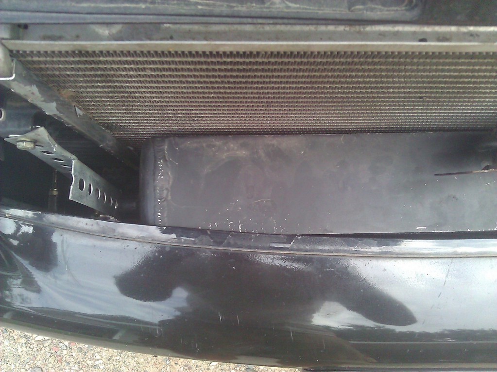

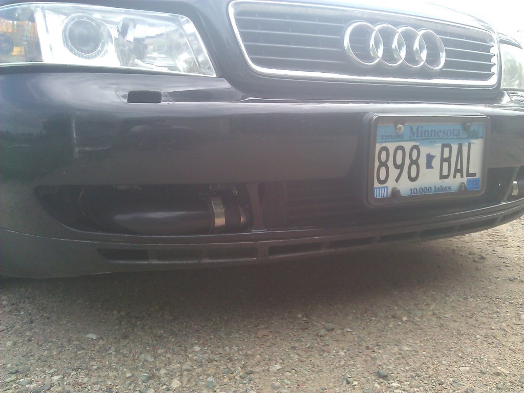

an off the shelf stage 3 tune will not work well for two different turbos that far apart. you wont get 325+ out of that turbo either. most people get 300 with a 2871r on a stock motor on boost at 20. youll need a tune that is optimized or what you want to run. but i did check it out and it seems like the tune would probably work decent either of those turbos.
as for the intercooler, i run a big treadstone tr11 behind my stock bumper with no a/c. most people told me it would look like shit, but it turned out pretty nice i think. i still had to hack a bunch off the bumper support, cant run fogs, and had to notch out some plastic
