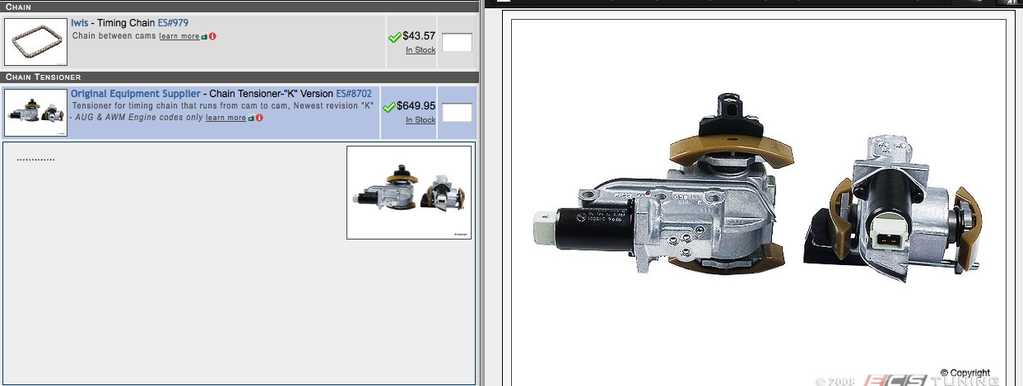

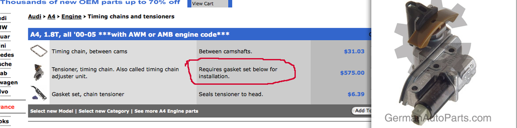

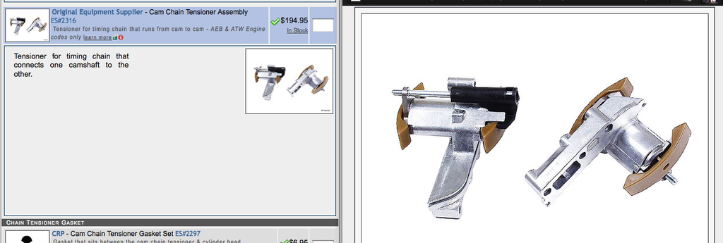

ok but whats the difference between these? beside the price? Which should be good?
or
or
it says that "Requires gasket"... so i have to get that too?

The difference is the engine codes. 2001 cars have a AWM motor. The physical difference is that the AUG and AWM have variable valve timing and the AEB and ATW do not.
You will need the gasket set. As far as the tensioner itself, you may be better off looking for a used one off a low mileage motor.
You really need to find out why there is no oil flow.

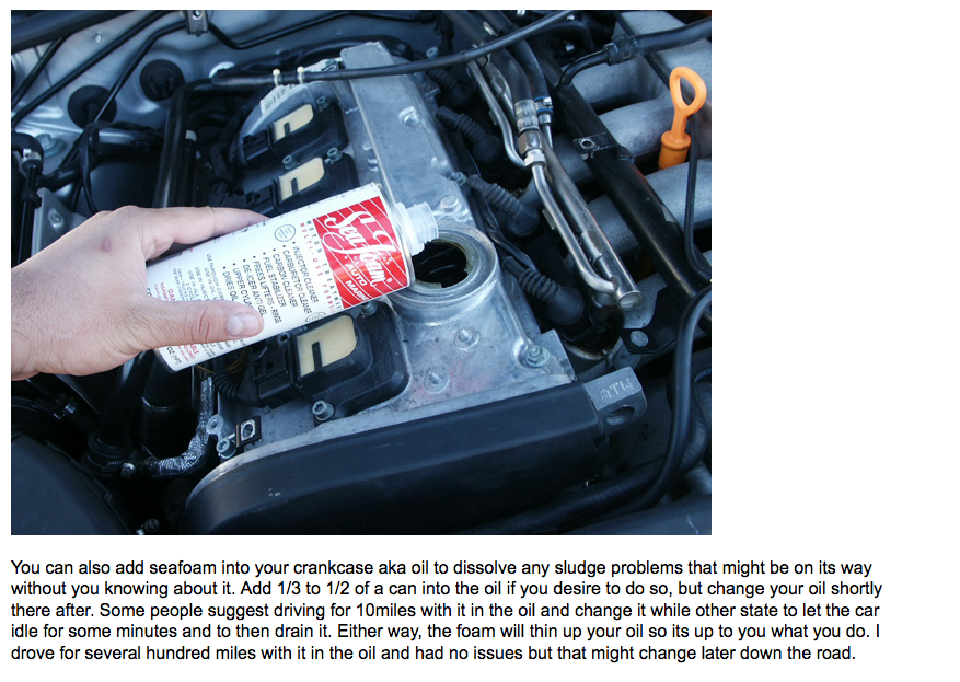

its the same seafoam as this one? or is it diff?
http://www.audi-forums.com/b5-forum/...4-seafoam.html
Old Sep 5, 2008 | 01:39 AM
  #28
onepoint8tee's Avatar
Site Moderator
Joined: Sep 2005
Posts: 13,664
Yeah, same product, but that DIY is for the intake manifold treatment, not your problem. You don't need a DIY article to tell you how to pour half a can of seafoam into your oil. Pick it up at auto zone or advance, etc. It's about $8/can.
Here is a better article:
http://www.audiworld.com/tech/eng89.shtml

so this will be good enough right? thank you, first thing im gonna do 2morrow, seafoam..
Old Sep 5, 2008 | 02:17 AM
  #30
Site Moderator
Joined: Sep 2005
Posts: 13,664
Yeah but do like auditech79 said. Don't drive for several hundred miles.
