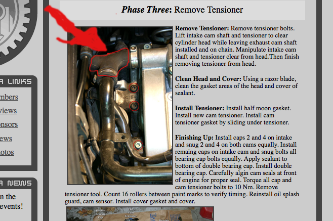

Originally Posted by auditech79
I would do it but i really don't feel like it....
What would it take for you to do it? A cookie? Two cookies?
Why's it so expensive anyways? It looks like it should take a decent shop about an hour.
http://www.ca-va.org/tech/camtensioner/index.html
