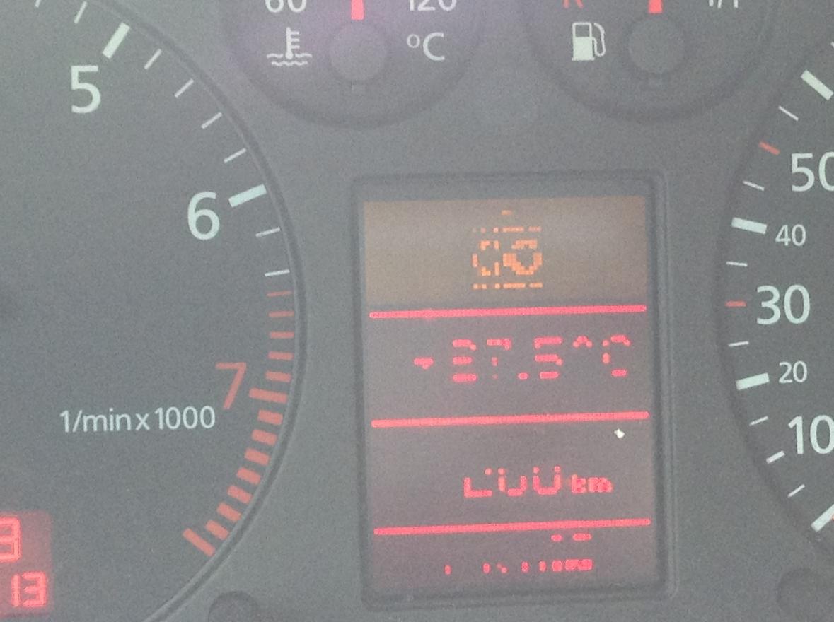

Got this warning light coming up once in a while. Can't find a warning sign in a book, that would look close to what I have. Could you guys take a look and tell me what you think. Thank you.
