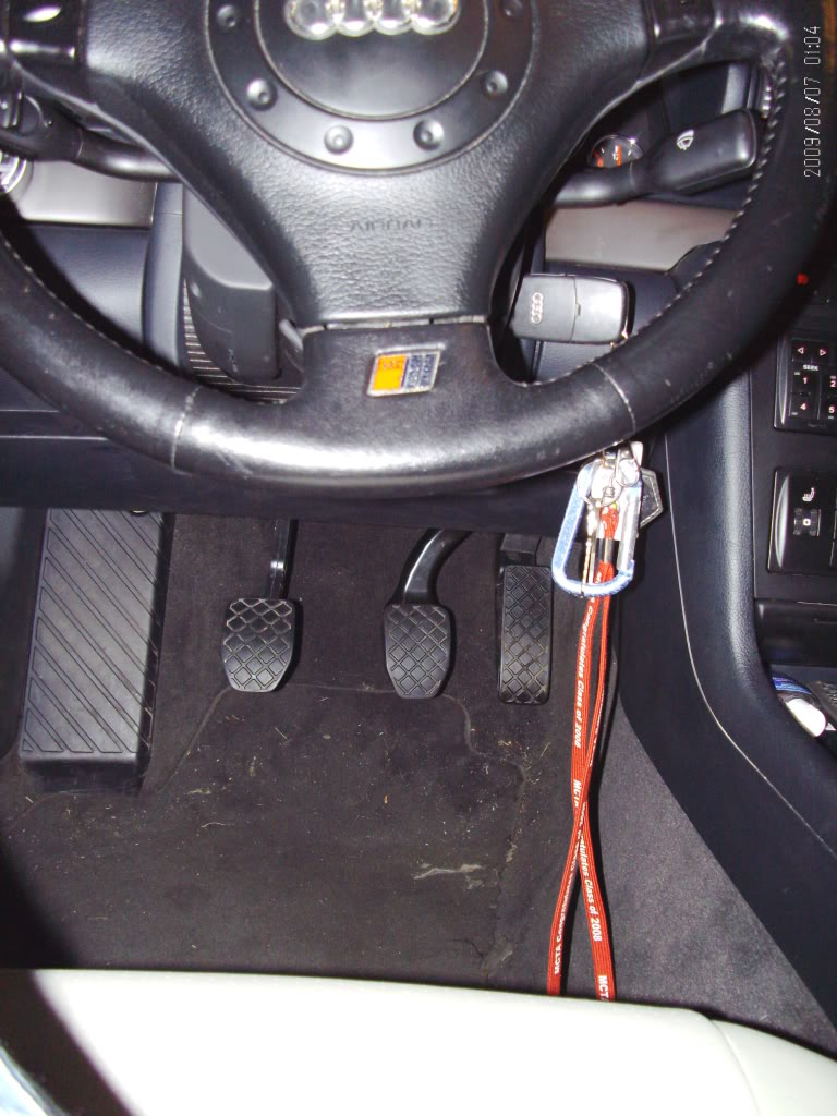

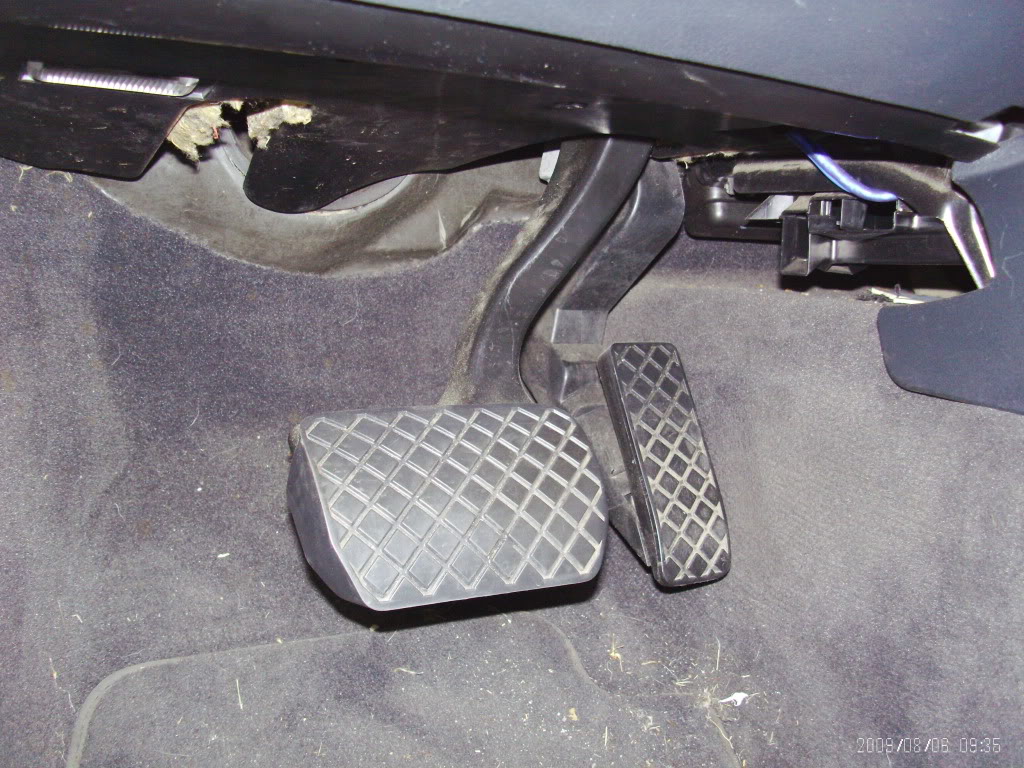

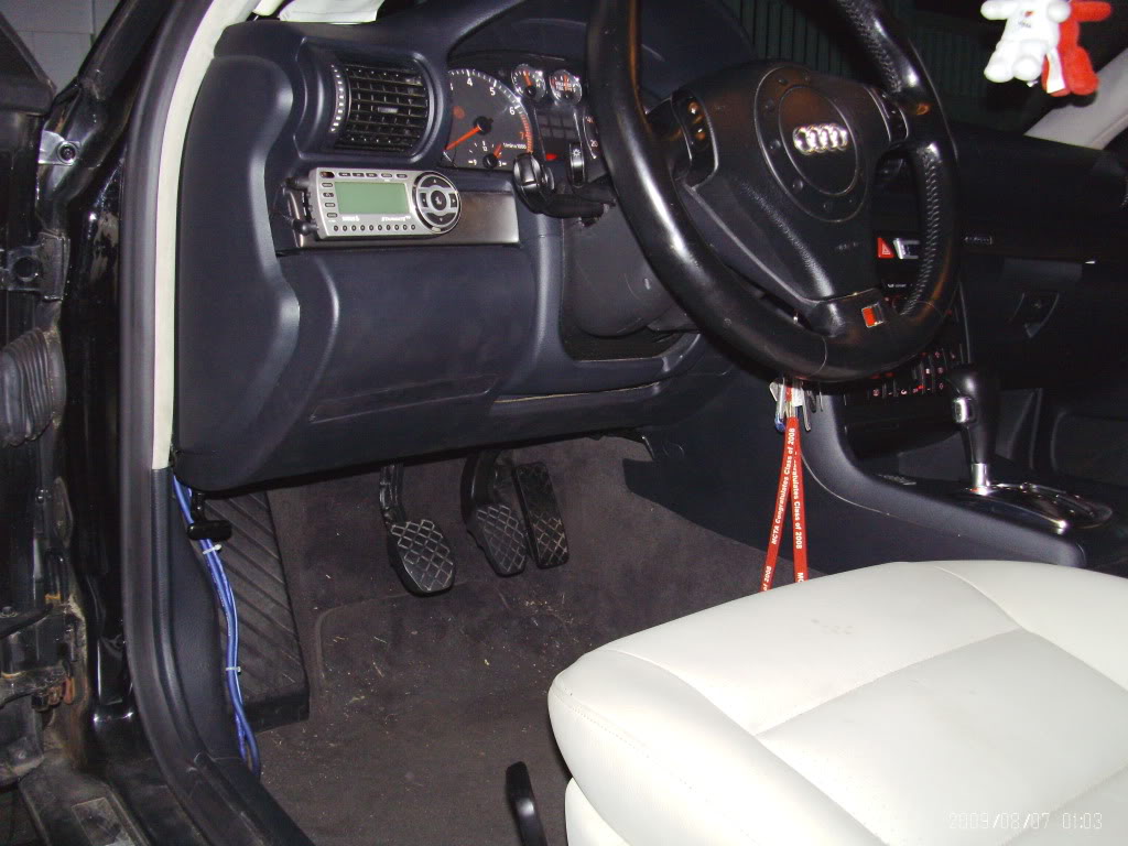

my M/T pedals came in the mail today, decided to install them now cause i know it would have been a bitch and a half later, it took me a good 3 hours, most of the time was getting the AT brake pedal out, the master cyl had some bad *** loctite on it and it kept getting stiff from me pushing on the pedal to try and move it around, plus being upside down in a small space isnt all that easy to work with, but all in all i got them in, clutch has no master cyl yet, gonna wait till im ready to do everything before i put that in, it has the tension spring in so it atleast stays in place. heres a pic. so pretty much by me doing this, this officially starts the process, and keeps me from backing out.
Before:
After:
