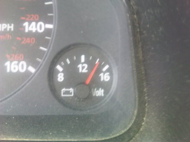

this is what mine reads while driving... this seems a lil high to me... maybe its normal idk... but i wanted to ask what others are running when they drive.. and if this is high... am i looking at a bad ground somewhere?

About where my runs, Sometimes under the 14, but I think your fine
ghost6303 Sep 30, 2009 05:33 PM
the battery is 12.6v, the alternator puts out 14v.
dragonrage Sep 30, 2009 05:34 PM
That's normal. Alternators should put out between 13.5 and 14.4 volts. Also, the gauge isn't perfectly accurate anyway.

ok just making sure... cuz most cars ive driven or owned the voltage needle is usually somewhere in the middle not almost maxed out lol
hiwords Sep 30, 2009 05:46 PM
it's normal. have you ever made yours go down to 12? it's kinda scary lol

That's pretty much where mine is too.

Normal.

Looks good man. usually somewhere around 14 running and 11-12 off if everything's good.
