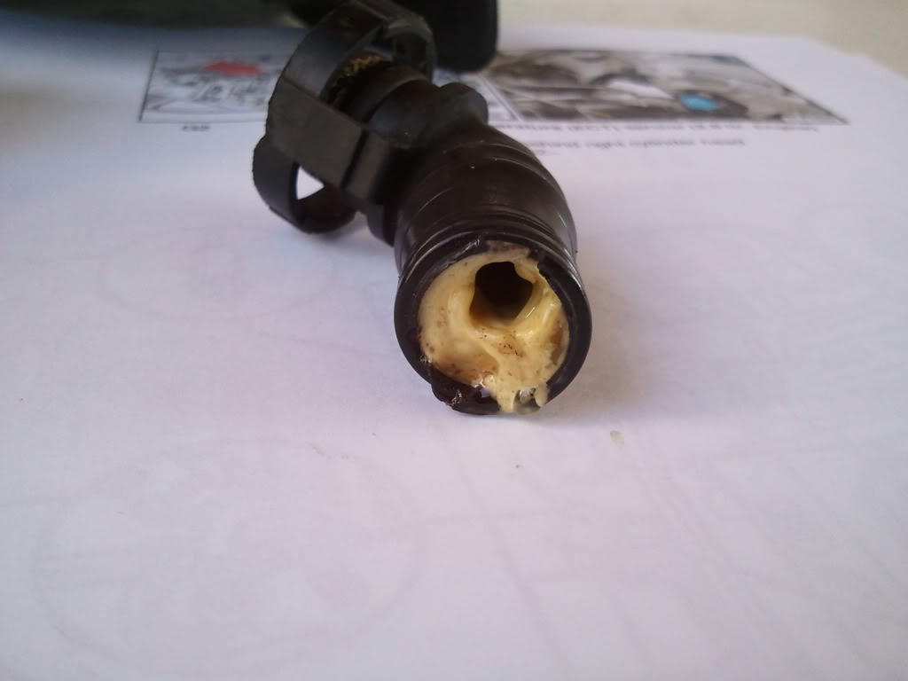

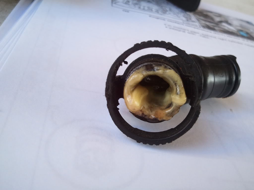

I get terrible gas mileage on my 1996 A4 2.8 (10 mpg1). Wanted to change the Engine Coolant Sensor today (Autozone does NOT have the black square 4 blade sensor, only green, oval, 4 pin).
Removed the valve cover vent hose (black, corrugated plastic, coming out of the rear of each valve cover).
Full of white slimy slime (and water?).
What is that indicative of?
Running filthy rich?
Plugged cats?
Bad PCV valve?
Or bad engine temp sensor causing rich and cold mix, causing the slime (and water/condensate?) No coolant loss.

This sort of thing can happen if you frequently run the car for short periods of time so that the oil never gets up to temp. Also, the PCV hoses being damaged probably kept any significant vacuum from developing in the valve covers. Without the vacuum, condensation has nowhere to go.
If I were in your situation, I would replace all of the PCV hoses and valve as well as removing and cleaning the valve covers. Then change your oil.

That white slime is normal especially in cold weather climates. I would replace the tube due to it being cracked.
As far as getting a coolant temp sensor from Autoblown , Don't! get a dealer coolant temp sensor only! They are only about $25 , also get the plastic clip that holds it in place & the o-ring that seals it.
