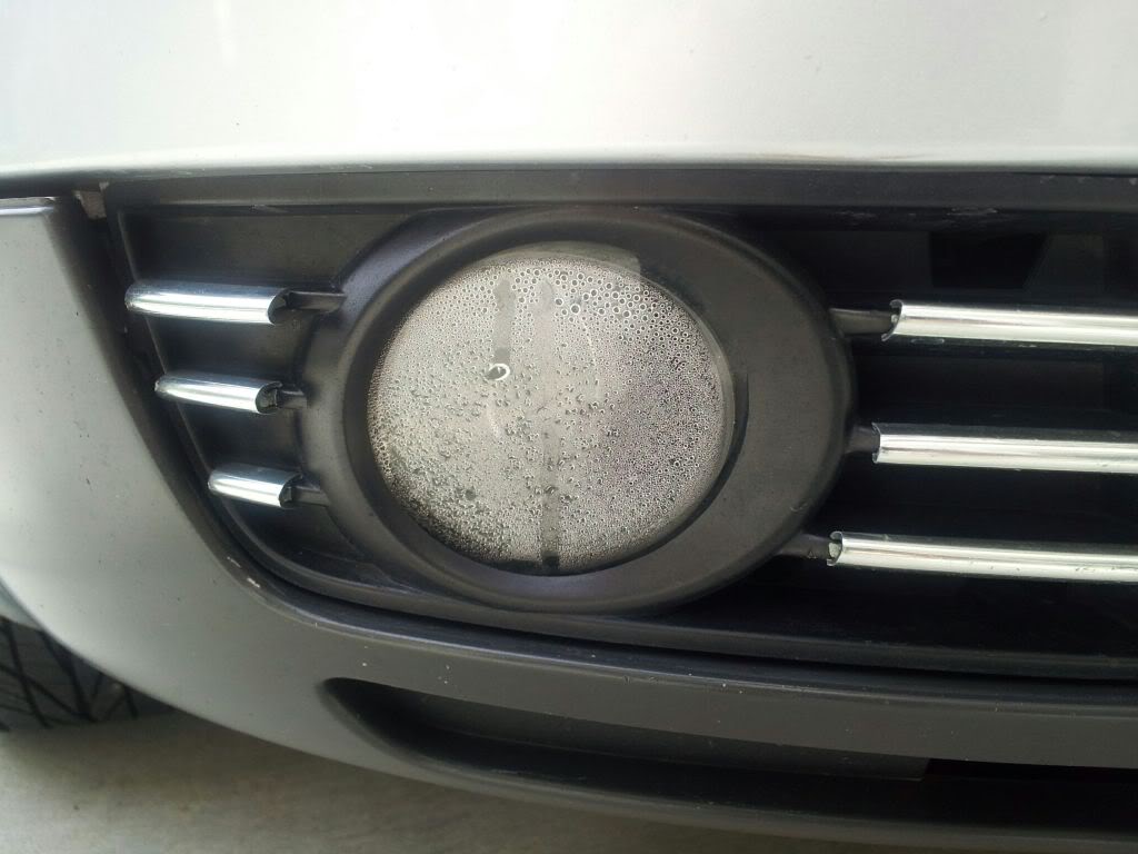

this morning when i went to go look in my airbox, i saw that one of my foglights has lots of condensation in it i was curious is this bad? im about to put hid foglights in but i dont want to put them in if its going to get wet and blow. it rained yesturday pretty hard for the first time in months

if u can remove the air box completly out of the car taking out the silence foam is no big deal. Basically as long as u dont snap any hoses u will be okay. I have never heard of anyone receiving any error codes from doing this either? Unless u oversoak your K&N and ruin your maf. I think there might be a thread on audizne reguarding the air box. As for your fog light. Probably the o ring not sealing up properly. When u change ur hids see if u can replace that o ring?

ill have to take a look on audizine for it, thank you. i took a look at it and i couldnt see much, couldnt really get the fog light out of there the cables are so tight doesnt let me move it much. when i get my hids though ill take a better look at it, hope its just the o ring to replace, luckily it doesnt rain that much in so cal. if its not the o ring would putting silicone around the plastic part of the fog light where the lense is help a little bit?
