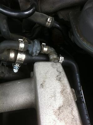

Well, I feel silly. The first time I went to look at the car it was dark outside, that's my only excuse lol. But I went back in the morning and this vacuum line had popped off....I reattached and everything ran like a dream. Drove to the nearest auto shop and cleared the code, which turned out to say "cylinder misfires."
Old 03-05-2011, 12:55 PM
ponyboy02's Avatar
Join Date: Jan 2011
Posts: 12
it was whichever line it is there in the picture that is on bottom. It doesn't normally have a hose clamp on it but I had to add one to make it stay put lol.
