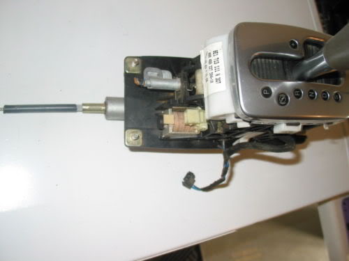

also my brake lights work so i know the brake light switch is working ,also the little locking mechanism does work bc it locks and unlocks when i put the key in and out but for some reason its not getting the signal that my foot is on the brake so it wont disengage??? so it has to be somthing inbetween the switch and seloniod????? here are a pic of the little magnet thing that controls the saftey hook, its the little coil thing at the front bottom of the pic above the wire connection...
