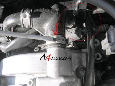

I replaced the valve cover gasket on my wife's car today (Audi A4 1.8T) and noticed that one of the hoses from the crankcase breather on the back of the valve cover was broken. I borrowed the attached picture from A4mods.com to show you what I am talking about. The hose is a little different than the one on our car but the circle is the location where the broken hose is.
It's the hose that runs down the back of the motor towards the firewall. Is this portion of the hose common with breaking? What is the part number that I need and how difficult is it to replace? I'll try to get a picture of it tomorrow if it's not raining.

Yea that hose is very prone to breaking. you follow that down to the actually breather on the side of the block. Everything plastic under there is prone to breaking

Would you happen to know the part number for that piece? Where the hose connects to the block (not sure if you would call it a "T" or a "Y" fitting), it's the portion that goes down and to the right. Do I have to buy the whole hose, or is it just a fitting that connects two hoses. I wasn't able to get a picture of it this weekend but should be able to get one this afternoon and post it up.
