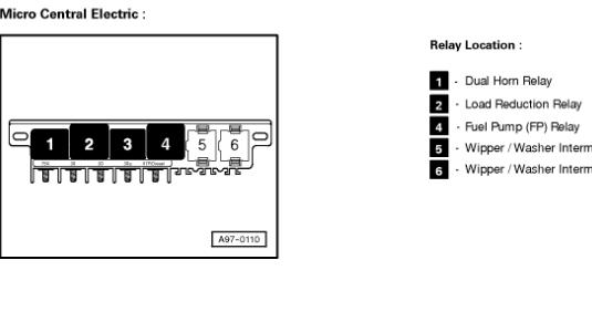

Hi, I am new to the forum and really need help! I am having problems with my a4 b6 2002 turn signals, wipers and horn not working, also when parked up for the night something draining the battery. I also have no power windows.. changed my steering control module today with no joy.. still have same problem???

If your carpet isn't wet under driver's seat....I'd say it's a bad load reduction relay maybe?..... It's the one under the dash on Driver's side I believe....See attached pic (for a B5, but my B6 has relays under the panel as well).

Carpet dry thankfully... Get checking relays thanks guys
