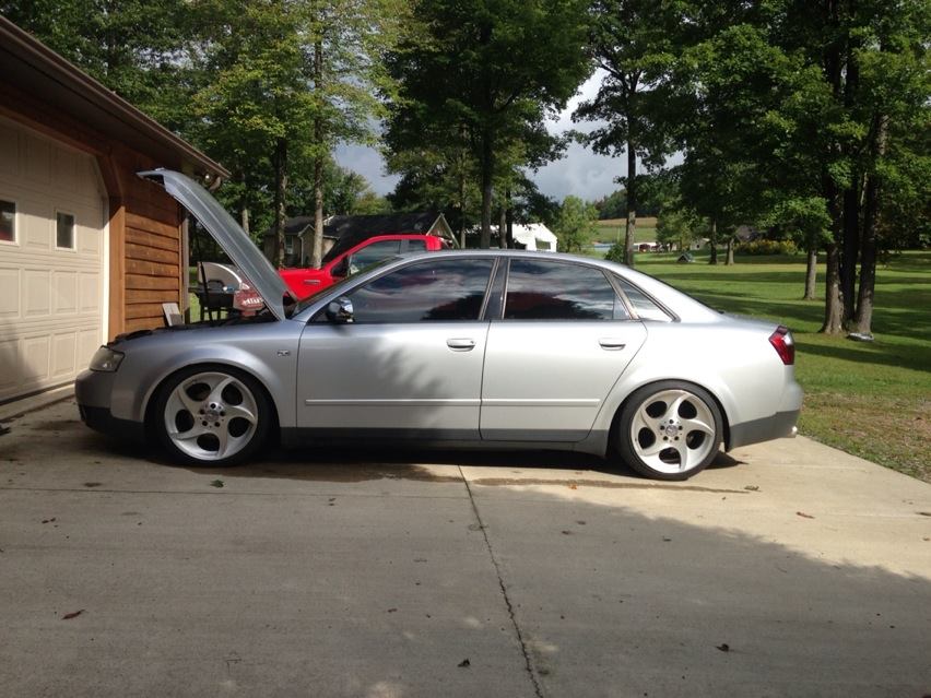

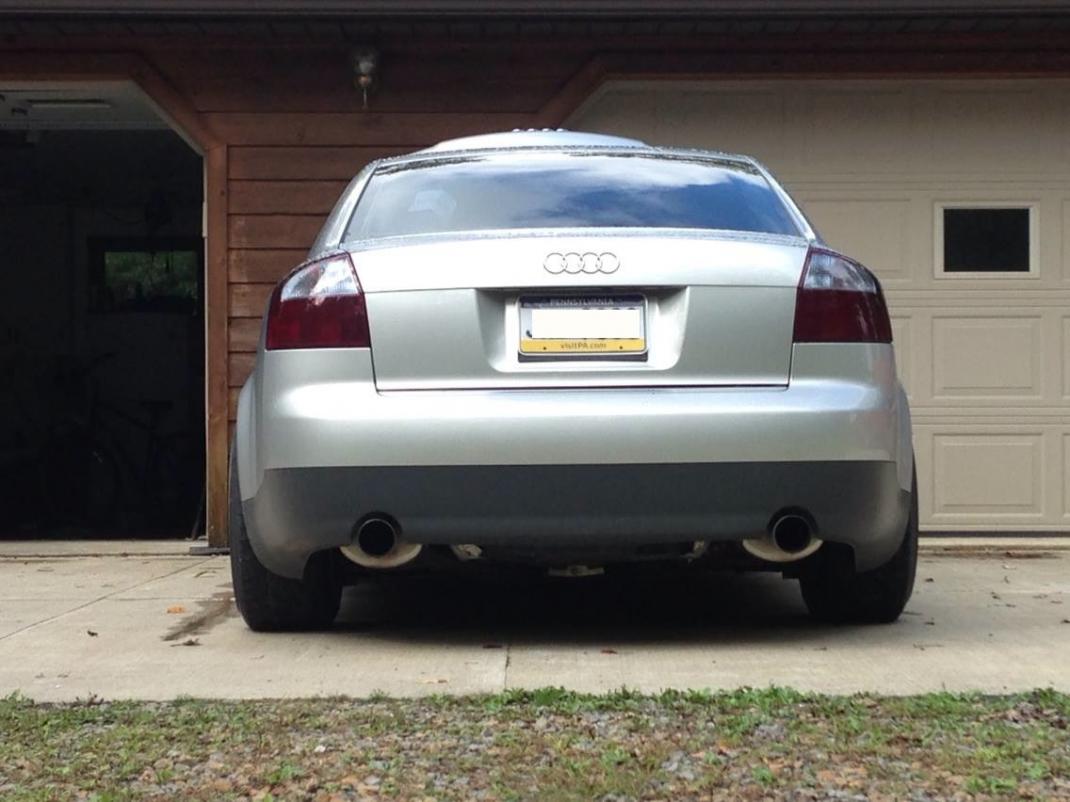

and just because i love her, here is a picture of my new mistress.
