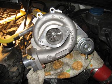

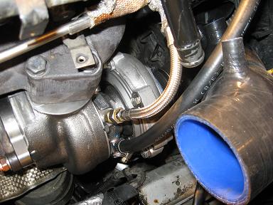

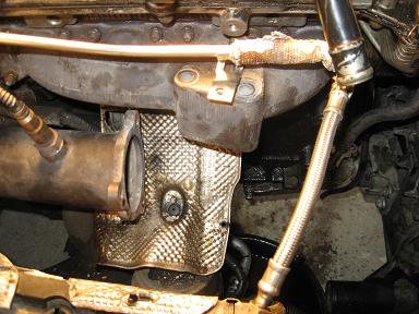

Just some pictures of my gtrs kit I installed on monday...
I went with usrt's 440cc inj. (needed a spacer), neuspeed tip, and revo stg3.
Its a completly different car,
I've got some videos and more pics of the finished install, so I'll get them up tomorrow.
