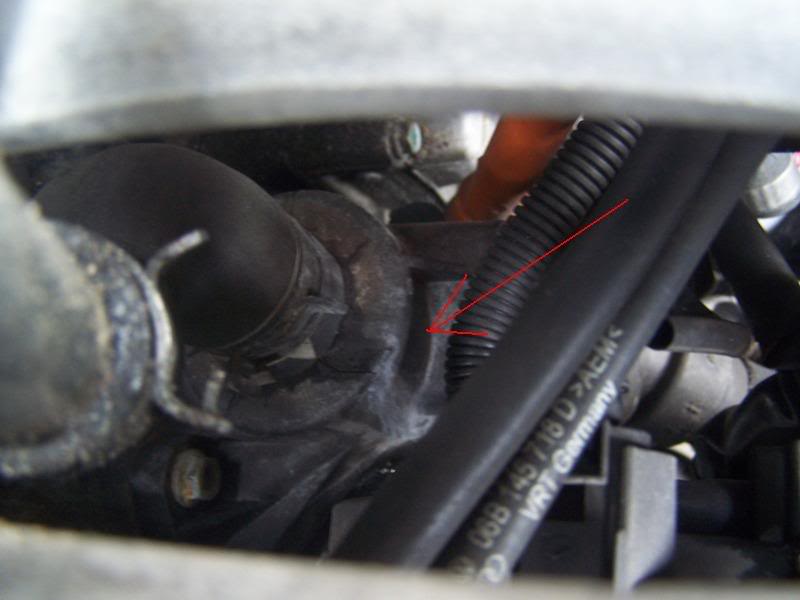

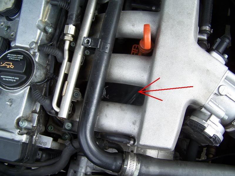

So, last week I was able to fix my coolant leak. It was the hose running from the heater core to the flange at the back of the engine, and my car ran fine for about a week and a half. Just the other night, i had yet another leak, from a different part of the engine. I've been able to pinpoint where, but I can not figure out what the part is, and was hoping someone here would be able to let me know. I have two pictures showing where it is. You can notice the crack in the part where the coolant is coming from.

Thermostat. Saved a bunch on mine by getting it from aboveallmotorwerks.com. Replacing it involves removing the alternator, but it was pretty easy.

Would it be the thermostat housing I would need to get then? The crack is going thru the black plastic part that bolts to the engine block.

It's all one part, you can't just buy the housing.
