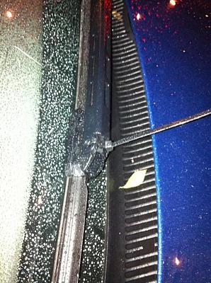

With the help of member JMA, I was able to replace my wiper blades on my 2003 Audi A4 with Rain-X Latitude blades instead of using the wipers from the dealer. JMA described it as a "hack", which I sort of agree with, but the hack is MUCH better than using the proprietary and outdated version of wipers from the dealer. JMA also says that it's ugly - I'm afraid I have to agree with him. Either way, it's worth the swap to me.
Basically, this is what you do...
1 - Take off the Audi wiper just as you would if you were changing it.
2 - What remains is the arm and a plastic piece that is inserted into the metal arm. Squeeze it and remove the plastic from the metal arm. (tricky, but can be done without damaging the plastic in case you want to replace it) Refer to picture 1.

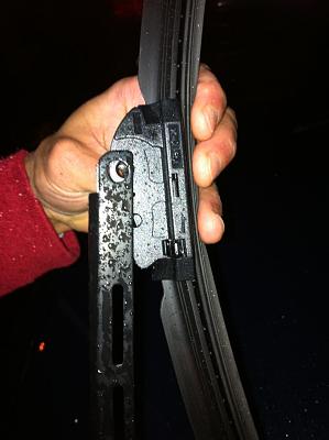

3 - A small metal insert will still be lodged in the metal arm. Squeeze that to remove it. I don't think the Rain-X wiper will fit in the arm if you don't remove this part. Refer to picture 2 (metal insert partially removed)

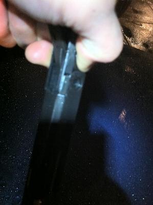

4 - At this point, take the Rain-X blade (with the adapter that came mounted on the blade in the package) and line up the holes on the wiper arm with your new wiper blade. Refer to picture 3
5 - Use a bolt and matching nut to secure the blade on the arm. (I used zip ties...speaking of hack)
