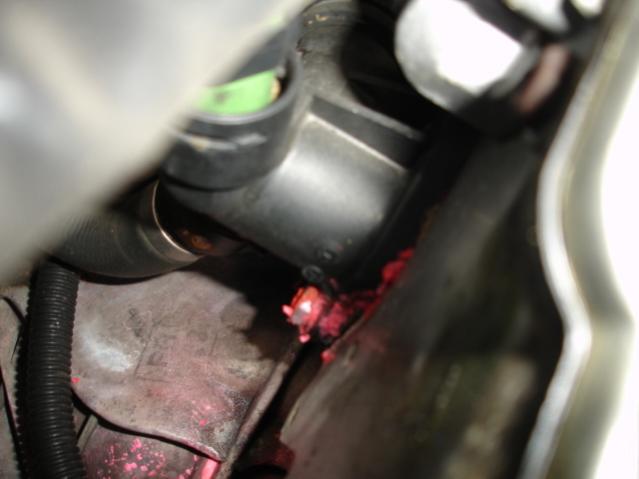

In the process of doing the above, I discovered another problem coming my way. There is coolant sipage on the coolant flange at the back of my engine block right next to the coolant temp sensor/sender. It is not leaking loads but I could see the distinctive build up of the G12 suggesting a slow leak. How difficult is it to fix this and what do I need please? A write up with pics will be very appreciated. I am going to attach a pic of the flange.
Attached Thumbnails Oil on the spark plugs Help Help Help!-leaking-coolant-flange.jpg
